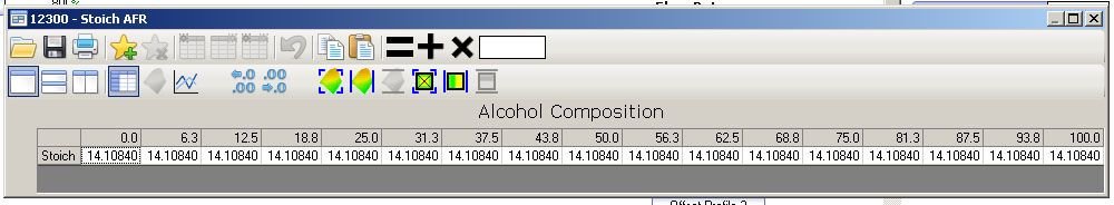

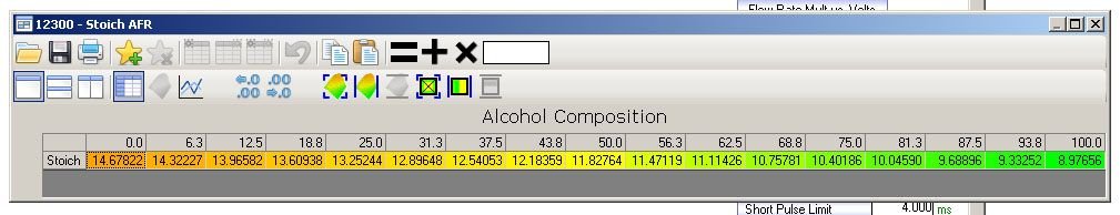

This is the stoich table for a 2014 Flex Fuel truck with direct injection (and it is the same for any flex fuel vehicle no matter DI or port):
This is the stoich table from the C7, which is not a flex fuel vehicle:
The stoich table only gives reference for fuel trims and contributes to calculating PE AFR. When you are running closed loop you want this to match the fuel in your tank so you can see accurate fuel trims. This does not mean the oxygen sensors switch at whatever is in this table, it means the fuel trims will be bigger or smaller if it doesn't match stoich for whats in the tank.
Clearly, the flex fuel table is variable based on alcohol composition....If you run E0 or E85, the alcohol sensor will reference the appropriate cell and keep fuel trims low, but also reference the other alcohol tables in the tune and adjust spark, fuel, etc accordingly.
The point is the silverado is NOT "still at 14.68." The O2 sensors always switch (try to maintain) lambda 1.0 and lambda 1.0 is always accurate....lambda 1.0 is NOT 14.68 unless you have pure ethanol free fuel in your tank, which I am willing to bet 99.9% of us do not. There are only a few pumps in the state of Texas that offer it and they are all in rural areas. E10 is what is out there and that is why, not only the DI C7, but all new OS's from GM (that are not flex fuel) reflect 14.108 as the stoich value in the tune. If they still used 14.68 then it would only trim 4% to achieve 14.108.
