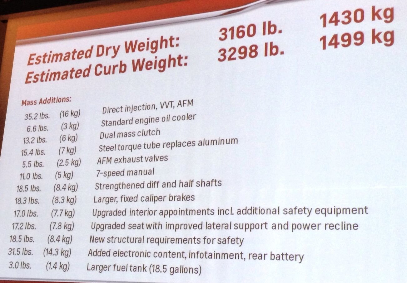

and some good info here on weight of components for the C7 vs C6 and why the car gained weight. Base dry weight is 3160 lbs to which you add 138 lbs for fluids and curb weight is 3298 lbs.
