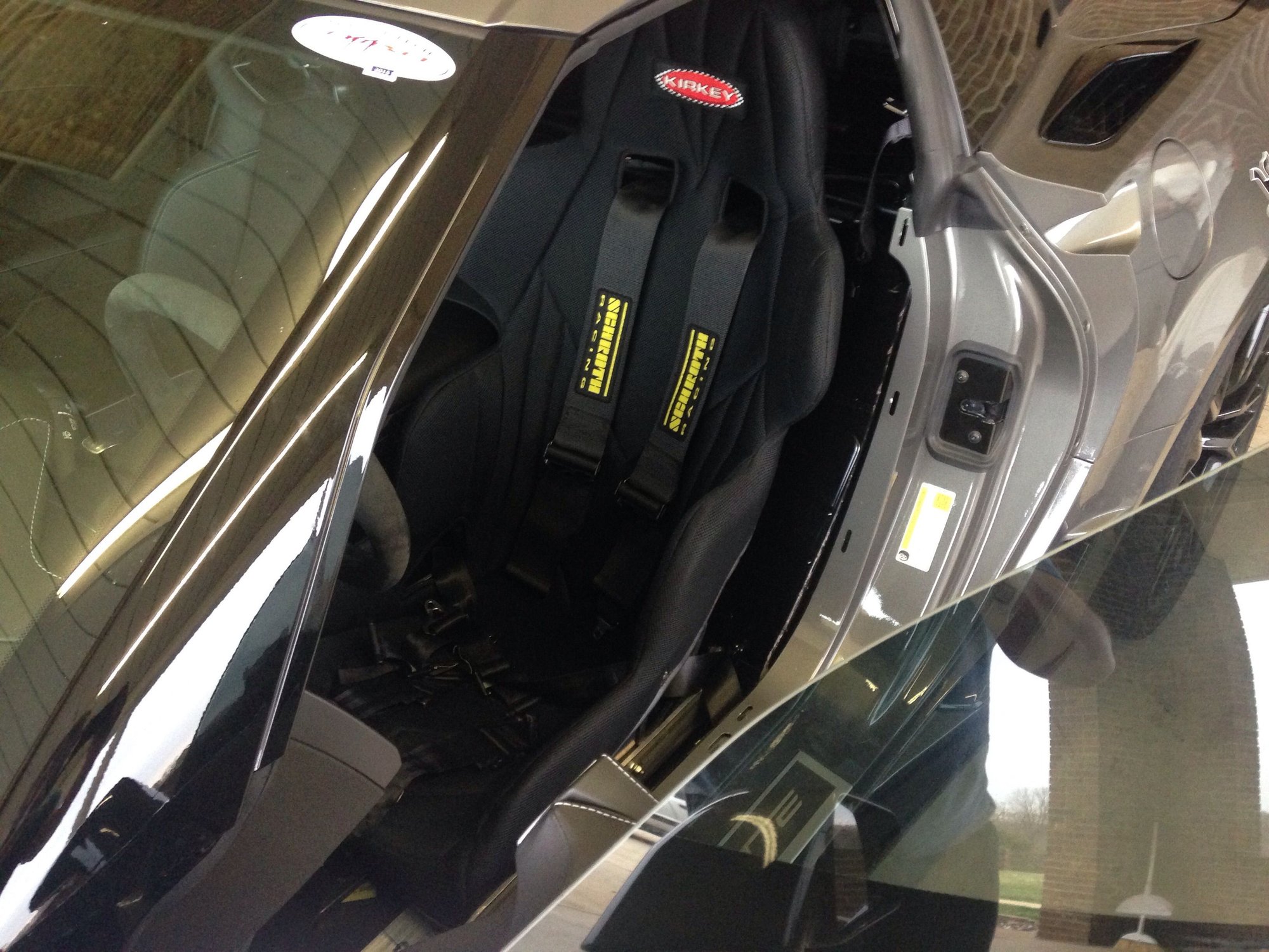

You won't get any codes. Been running my Kirkey race seat in my 2015 z06 all season and zero codes. You get a service airbag message at start up but you hit the select button on the steering wheel and it goes away. Only Catch is, your airbags no longer work nor your 3 point belts.
Funny... same except seats and belts just installed. What mounts are your Kirkeys on? Hardbar here. Didnt fit nowhere near as well as in my C6.

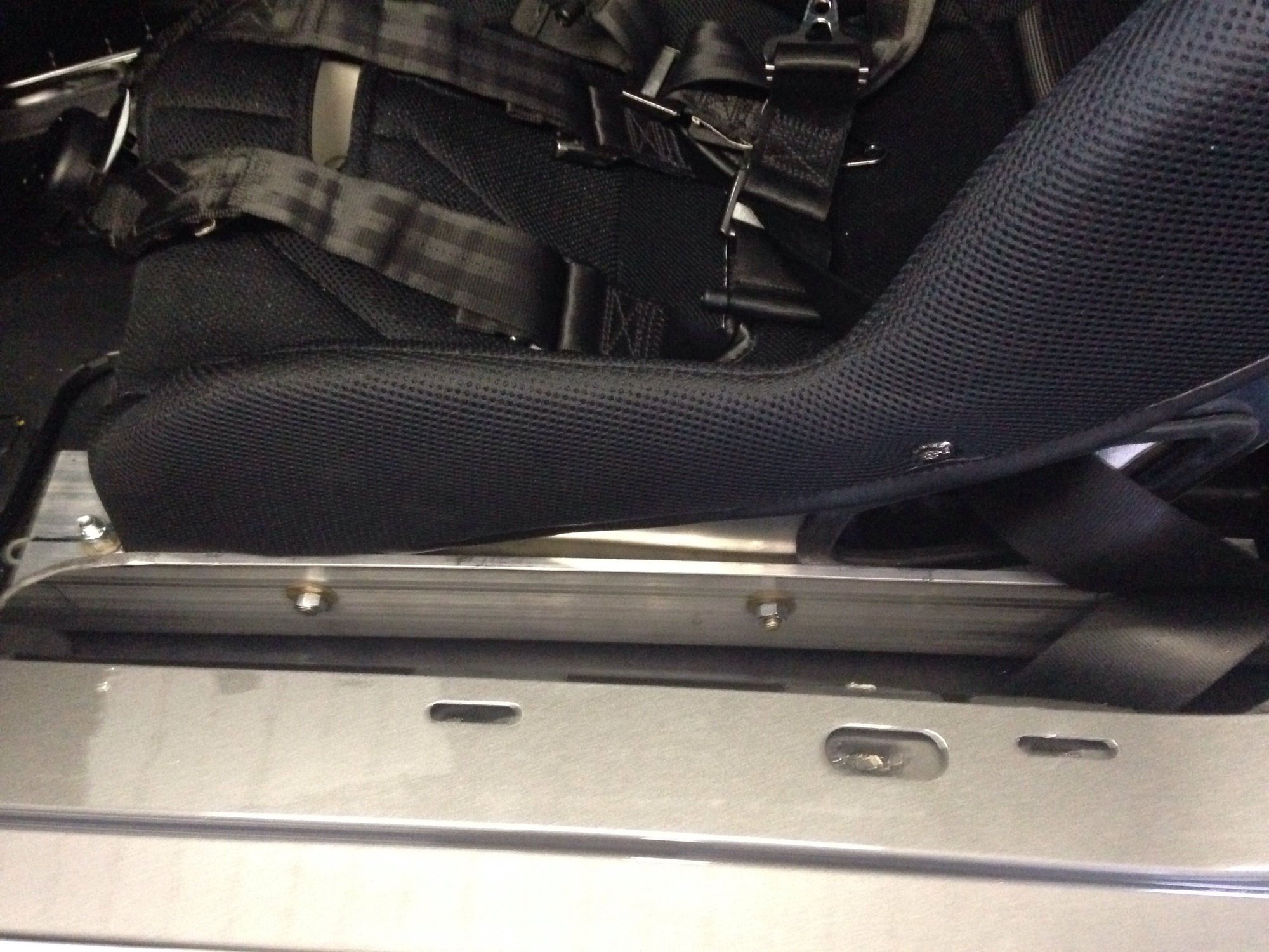

Custom mounts. Seat is fixed however so it was a pain getting it in the right position but with it fixed, I sit very low

How hard was it to screw the mounts into the rear posts? I'm looking at the seat and mounts and it seems with the seat all the way back you wouldn't be able to reach the rear seat studs?
EDIT: I see your seat isn't all the way back, like mine would have to be. Before I commit, would it be possible to somehow do those rear bolts with the seat all the way back? Also, would you share where you got your custom mounts and what they cost?
How tall are you if I may ask? I am 6'3 and all the way back is to much for me with this seat. Reason is, you literally sit in the seat vs on it with the stock seats so you gain more leg room. Are you planning on having a fixed seat or are you wanting to have the ability to slide back n forth on rails? Reason I ask, is my buddy did with slide mounts and he barely gained any head room vs mine being fixed, I gained probably 2-3 inches because I can literally sit on the seat mounts on the base of the car. Con is, it's a fixed seating position. I do believe they do make a low profile seat rail but I am not sure how much you gain in head room.
These mounts were custom made by a buddy of mine who owns his own race shop. Once you decide and if you want to go the route I did, let me know and I can ask if he can fabricate some. They arent the prettiest in the world but they are rock solid and pass all the regulations .
