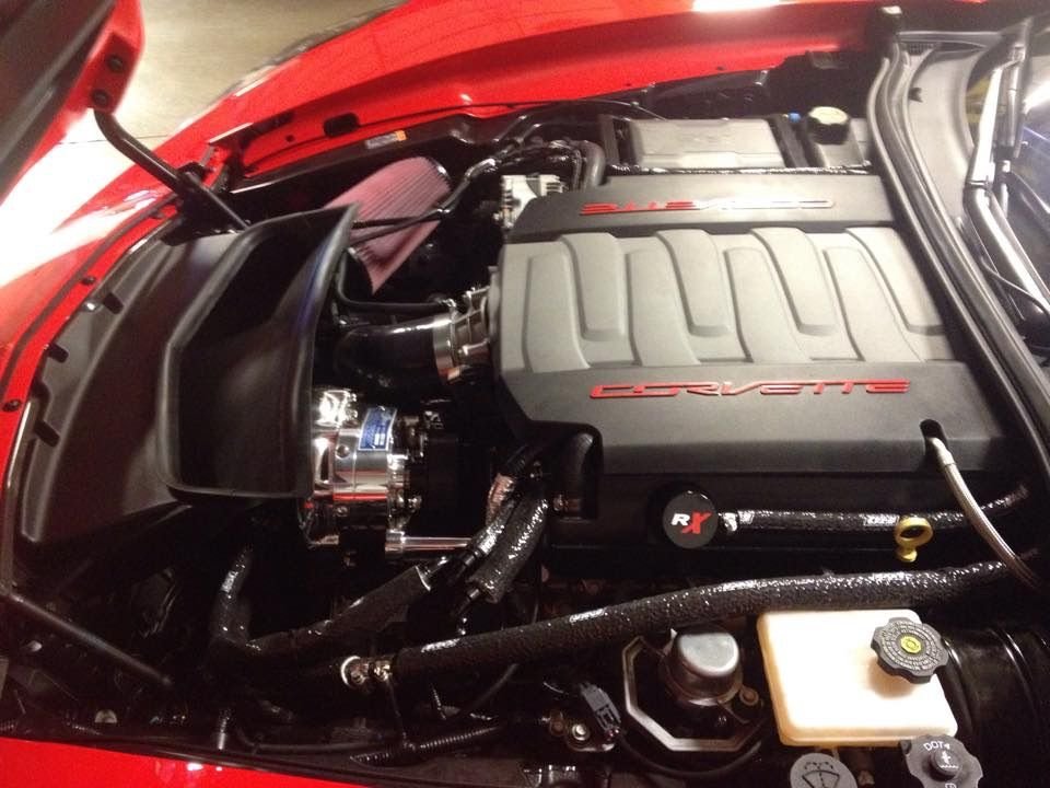

Old Mar 5, 2015 | 03:50 PM
Little Red Corvette1's Avatar
Joined: Aug 2014
Posts: 233
Likes: 23
From: Tucson
2016 C7 of the Year Finalist
Default What about polished vs. black?
Originally Posted by davidtcpa
What about polished vs black.
Here is a pic of a polished unit. This is my car. If I did this again, I would get black.
