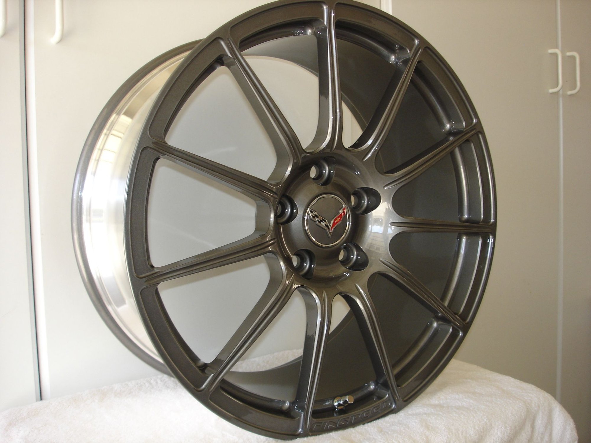

Andy, check out forum vendor Finspeed's offerings at http://www.finspeed.com/performance-wheels/f10/.

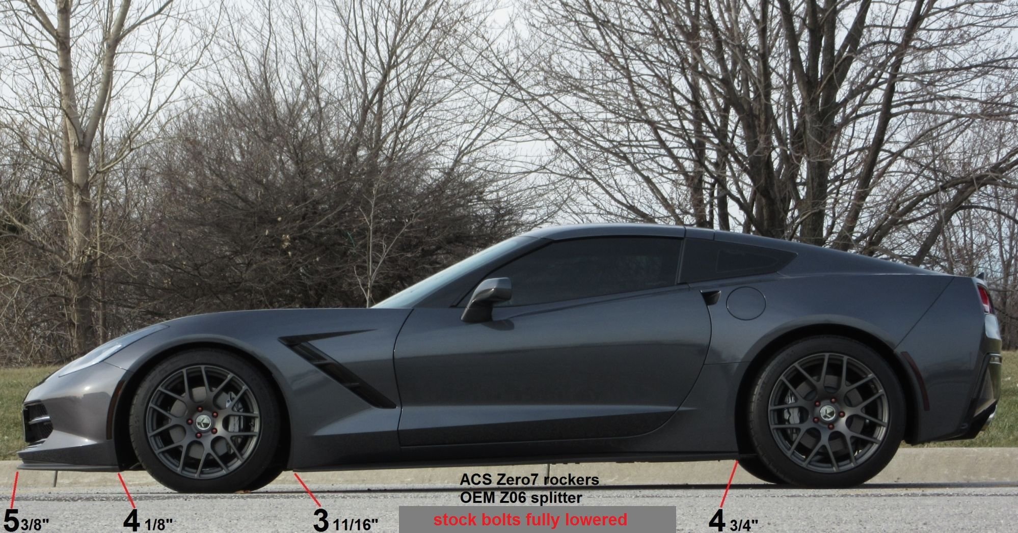

Talk to Daniel about your custom requirements and he'll build you a very nice set of fully forged wheels at a price near the HRE Flowforms and certainly a long way away from those $7000 wheels. Here's a picture of the stock width and offset wheels he built for my C7 Z51. Of course, they have many different styles and colors.
Ernie
