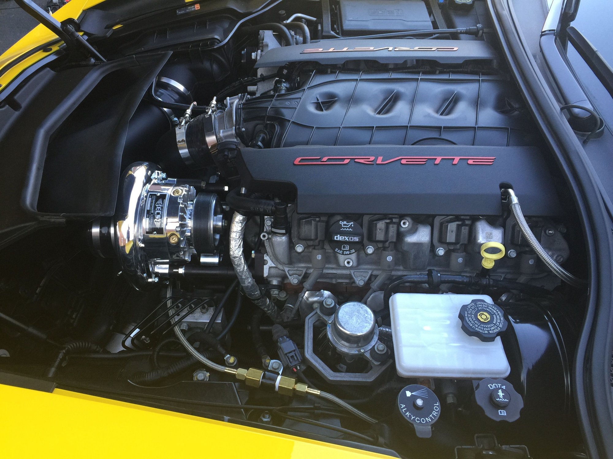

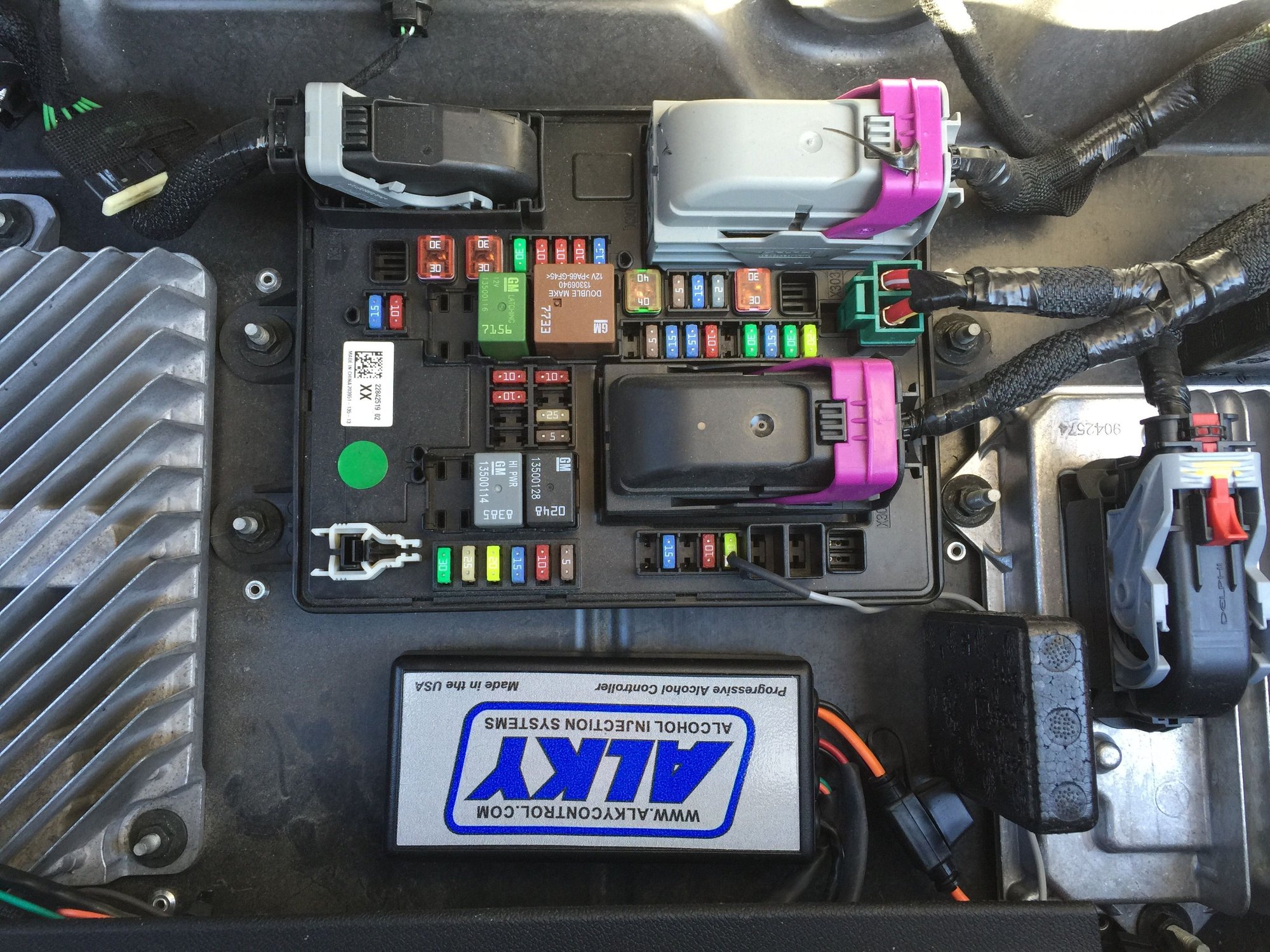

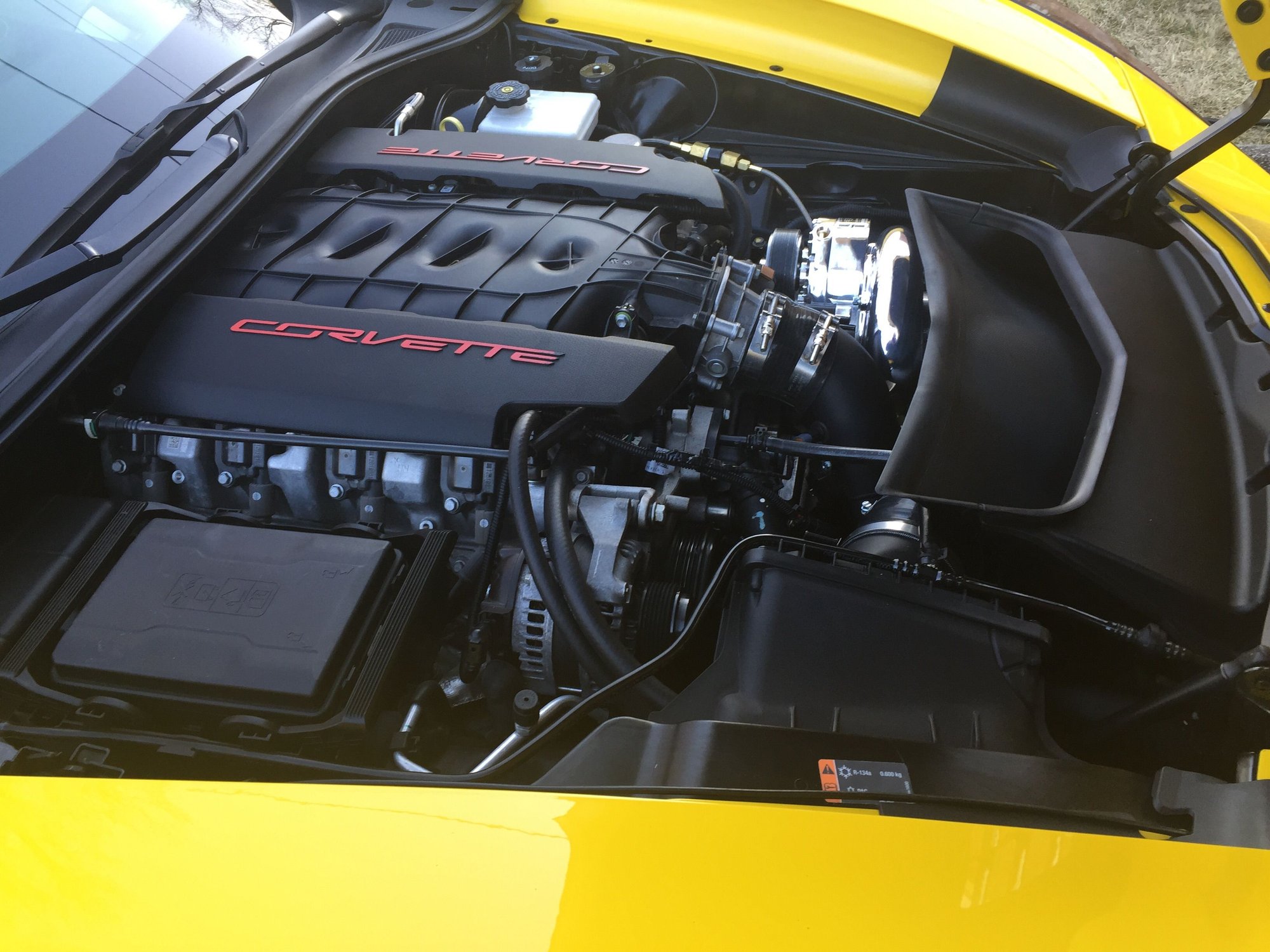

Here's some updates on the install! Everything went very smoothly. I chose to mount all of the methanol electronics in the trunk and mounted the led in the center of the trunk plastic under the hatch lock to see through the rear view mirror. Not really a big fan of having aftermarket electronics in sight!

Thanks everyone! I worked on this about 6 hours each day on the weekend and after work yesterday. I would say I have about 15 hours in it all together. Knowing what I know now, I would say I could complete the entire thing now in 10 hours (meth and supercharger). I chose to take the bumper off to install the aero, and I think it is a worthwhile choice for anyone installing the kit (although not necessary to complete!). I will dig up all of the part numbers for the aero kit and post them this afternoon.

sorry for the delay in updates, I was able to have Doug from ECS tune the car last week and the numbers are as follows:
2200sl Paxton on 4.1 pulley - 11psi currently
Stock exhaust manifolds
Stock cats (4)
Stock non-npp exhaust
Stock air box assembly with STOCK air filter (green filter backordered)
alky control w/ one nozzle and iat breakout
682 whp
630 tq
Pulls like a freight train, and the stock exhaust sounds completely different with all of the flow (sounds like an open wastegate on a turbo car)
Very pleased overall, will be shooting for 800/850 with an open style blower inlet and 2" long tubes on a slightly smaller pulley this summer!
While i was at the shop I picked up a 160 lingenfelter thermostat and installed it after the tune. Much less of a mess to install this one vs. my old c6. Car now cruises at 165/168 instead of 210/220 and oil temps stay in the 170s on a non z51. Best 30$ mod out there.
