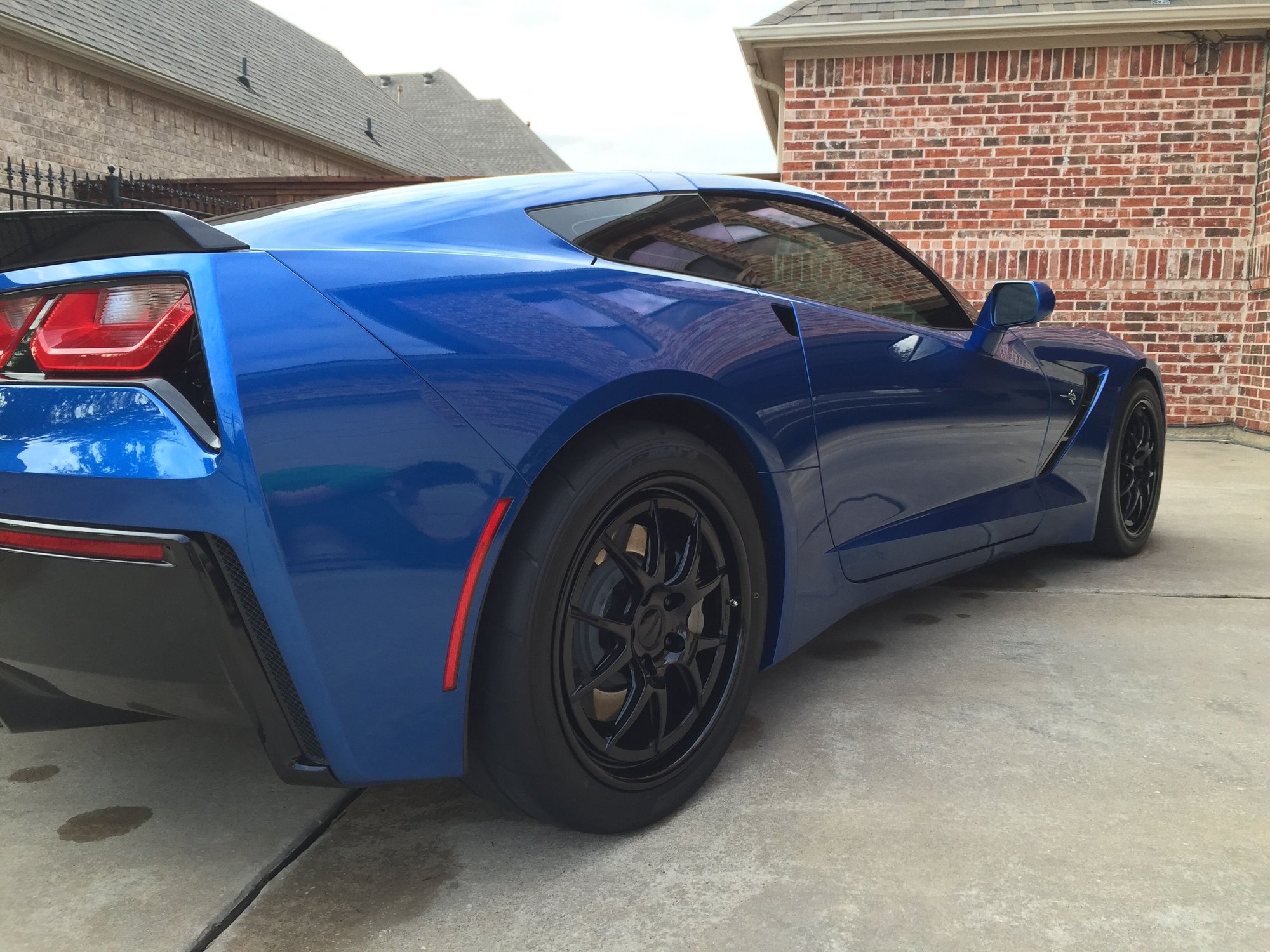

Here's the car... Post supercharger install and new Forgelines.
