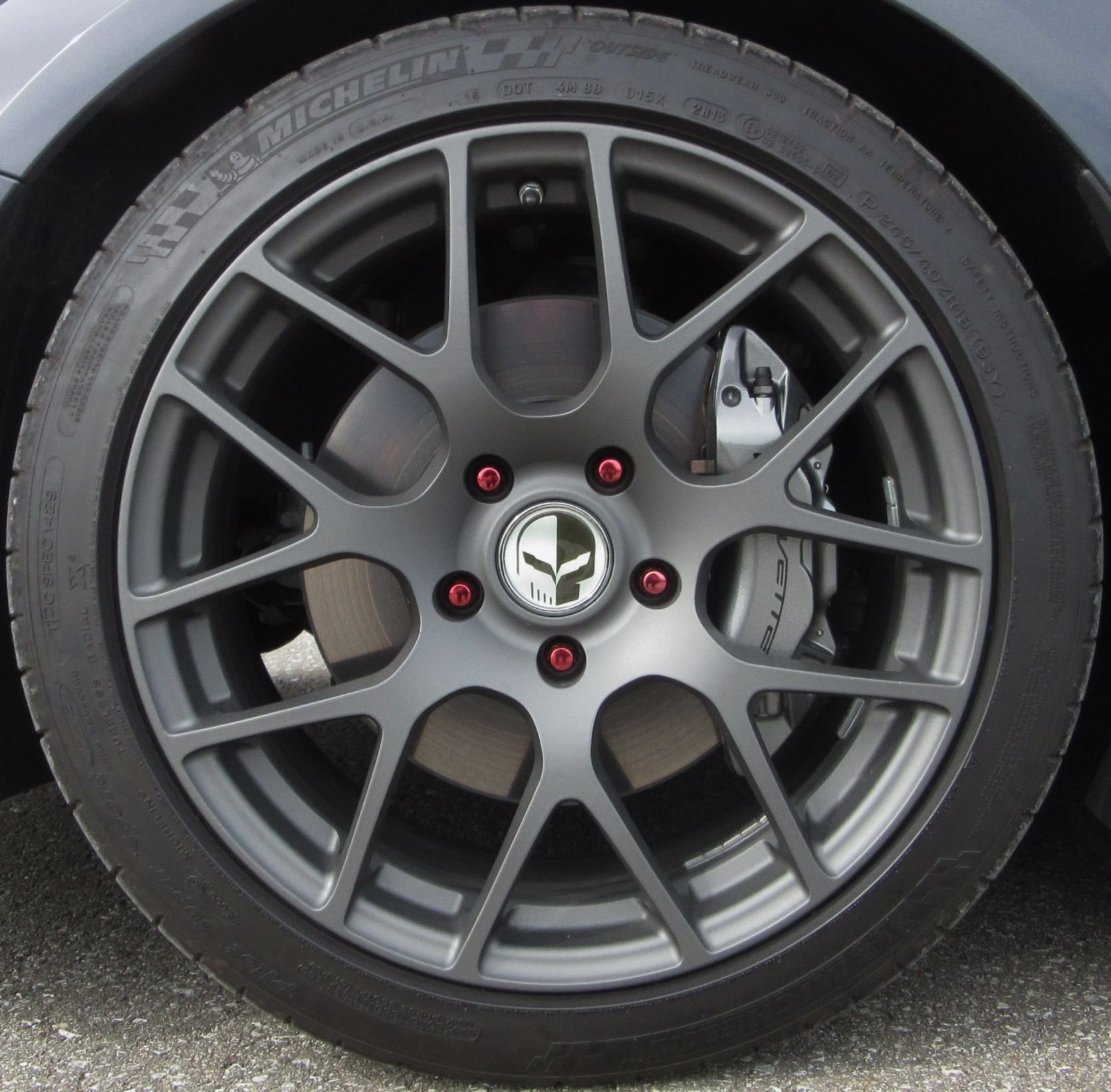

I had ordered a set of really great looking wheels for my base C7. Was assured by the major vendor that it would be made specifically for the C7. When it came in, it was touching the brakes on the front and back wheels.
I am beginning to understand some of the reduced offsets that some of the wheel makers are putting on their C7 wheels. Many are reducing the offset, apparently in order to clear the brakes but, in the process the wheels and tires get moved outside and they rub on the fenders, particularly at the back of the car.
My wheels were sent back with the surprise note that if those wheels were built for the C7 specifically, how come the manufacturer never actually tried it on a C7 to see that they won't work. I kept my deposit with the promise of a modified design but, I suspect it will come with reduced offset and the possibility of fender interference. Hope not, will report back if/when I get it. It was a beautiful set of wheels, super reasonably priced.

Exactly. Just as I suspected the manufacturer declared that they could not modify that particular really nice wheel to fit because of the brakes sticking out. I finally went for a set of Z51 wheels not seeing any really good, reasonable alternatives with the proper offset. Since I lowered my car I can not go for less offset and the resulting fender interference.

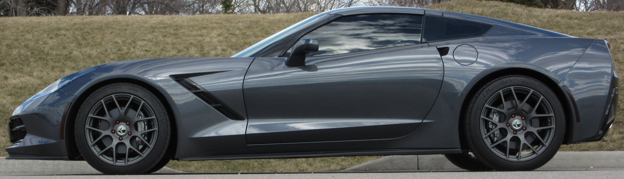

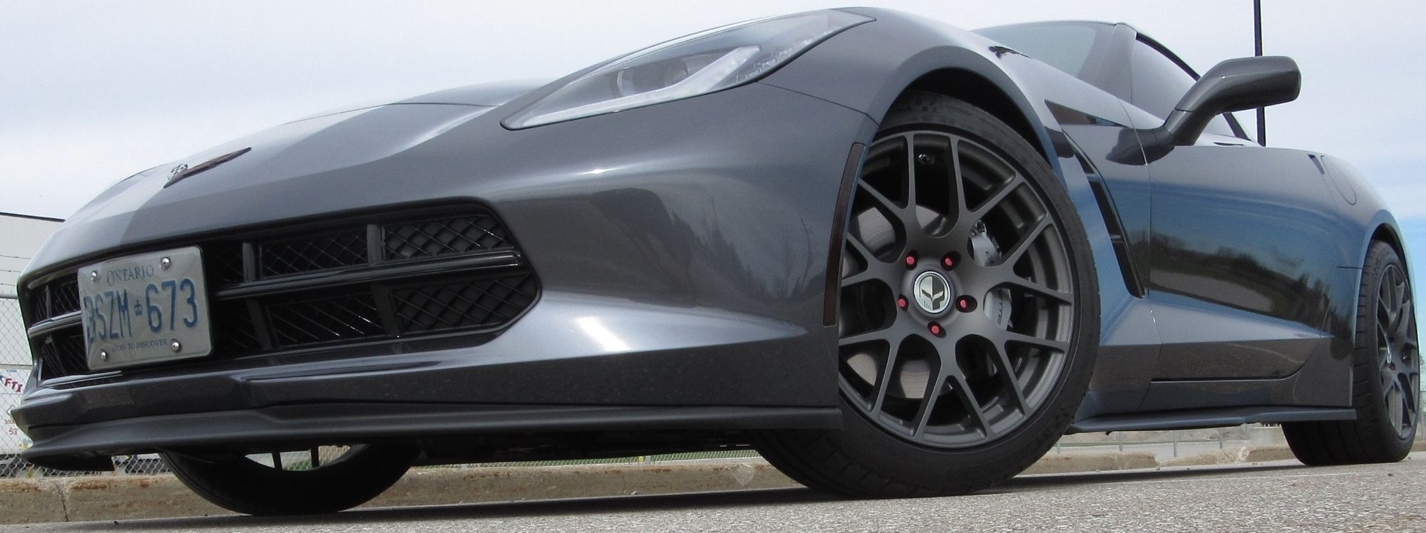

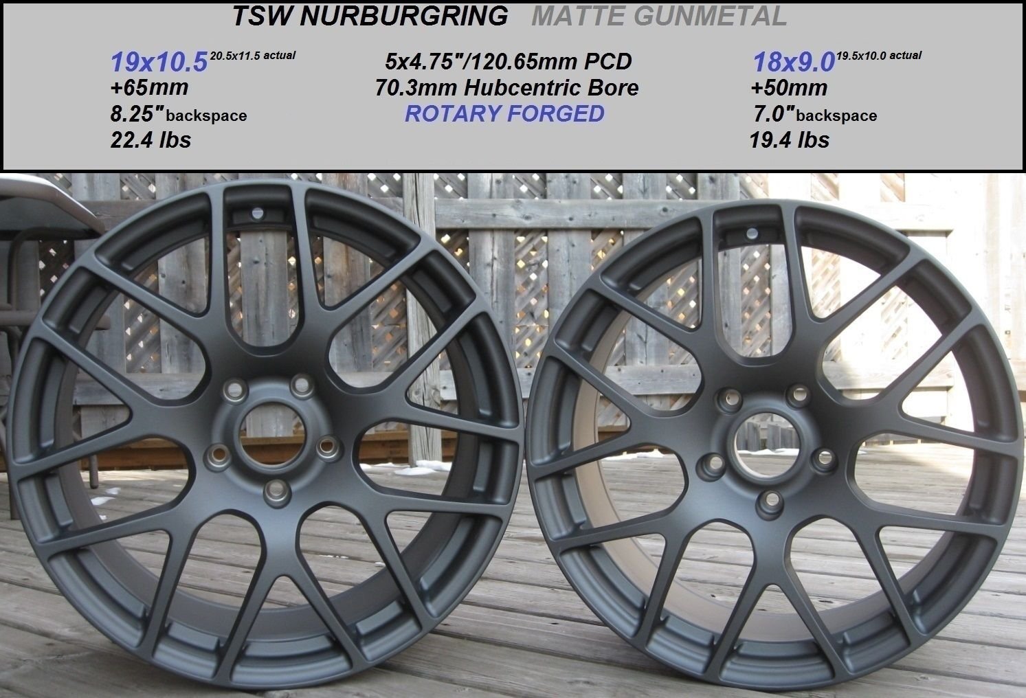

stock tires/stock bolts/full drop, great fit/no rub, lightweight/rotary forged, $1050 shipped

Jake - those Nurburgring wheels look fantastic on your car. However, I have read a good number of people posting that their rings are touching the rear fenders. That would not surprise me as they are not only 0.5" wider but, also, have rear offsets that are 14mm less, making them stick a total of 20mm further out than stock.
As my car arrived from the factory with the base wheels they had positive cambers on the rears (love to know why?) and when I drove over a couple of dips at 70 MPH the tires touched both rear fenders... yes, with the stock wheels. Now that I put negative camber in them, it is no longer an issue but, the experience had made me stick to the factory offsets.

10k...no rubbing issues

You either are driving on perfectly smooth roads or something else. I would have LOVED to get the Nurburgrings as they are light weight, look great and the price is most attractive but, I absolutely don't want fender touching on my car. Just looking at your very top picture the rears appear to be out far enough where going over a good dip would make them touch.
I actually called and asked a dealer why they would make them with less than factory offsets. He would not answer but, I found out when my originally ordered wheels and my stock wheels touched the brakes or the fenders. Many aftermarket wheels are built for multiple car applications and their spokes will touch the C7 brakes if matching the factory offset. So, they resort to moving the whole wheel out by reducing the offset because they obviously do not want to cut from the spokes. The C7 stock rear offsets (79mm), particularly, are rather large and radical so, few wheel manufacturers would want to make even larger offsets that would work well for wider-than-stock wheels.
Like I said, I would LOVE to have the Nurburgrings but, only if they made it to the stock or even larger (by 6mm) offset.

That's a laugh...roads are brutal after 2 severe winters. Suspension gets hammered. Rare treat to drive a short section of smooth pavement. No tire marks on rear fender lips.

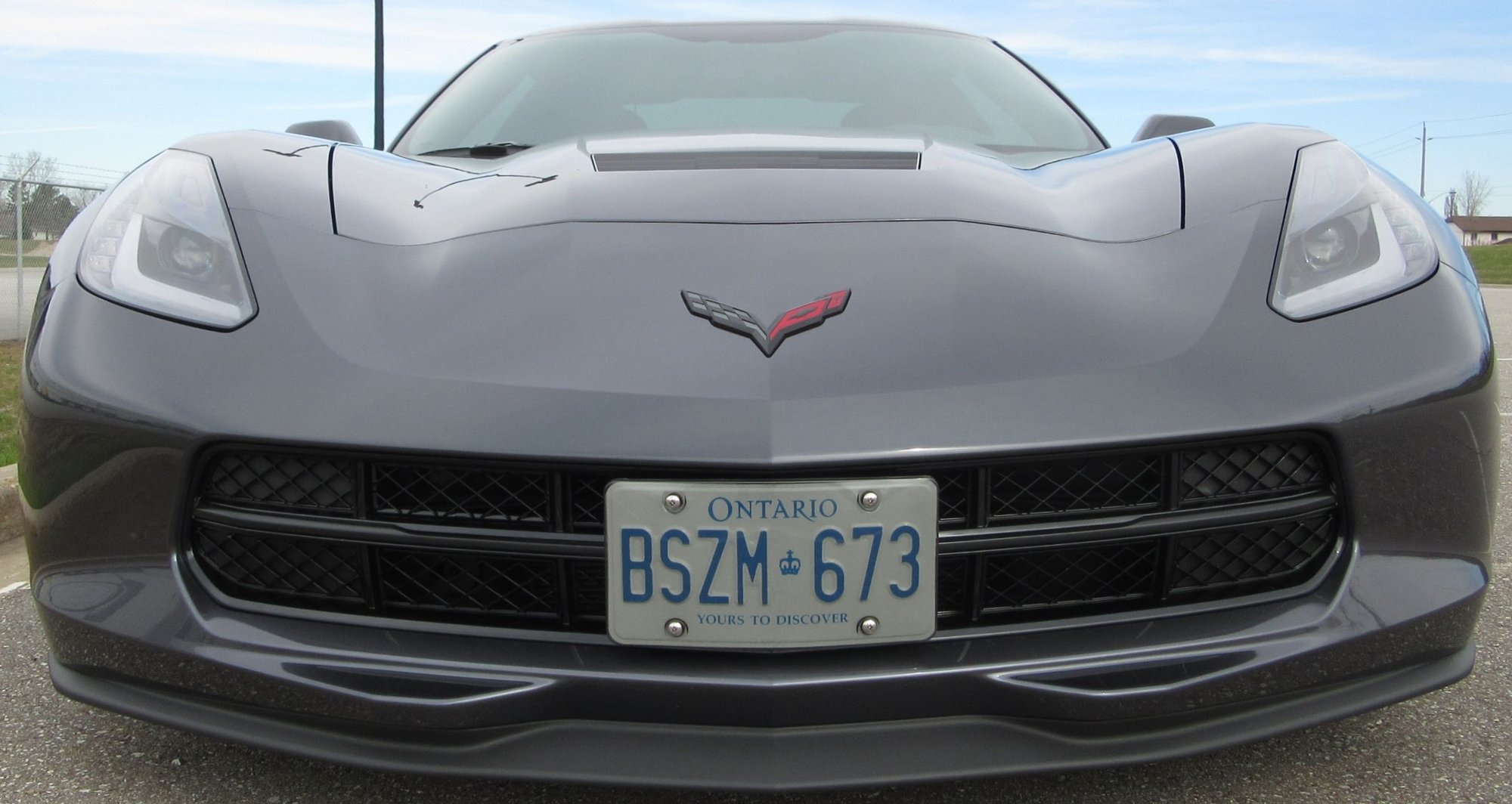

Stock bolts down all the way...splitter scrapes
If I ran lower deflectors, they'd shred.

Ya clearly tempt fate w/wider tires/chopped bolts. I like the stock tire, full drop/stock bolt rake + no rear tire rub on the roughest roads/RRX. Splitter's made to flex when scraped & cheap to replace. No way I'd further lower the rear on chopped bolts.
I've less than 4" clearance @ the front of the skirts.
