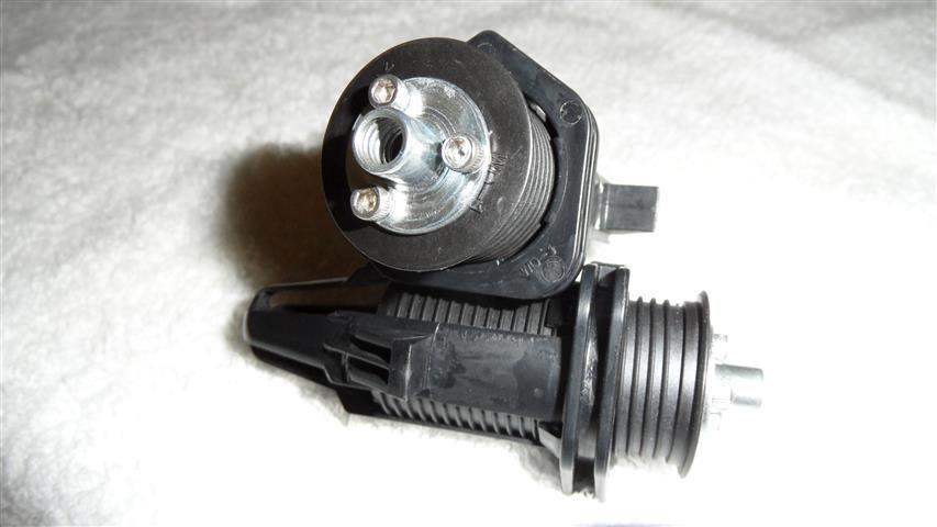

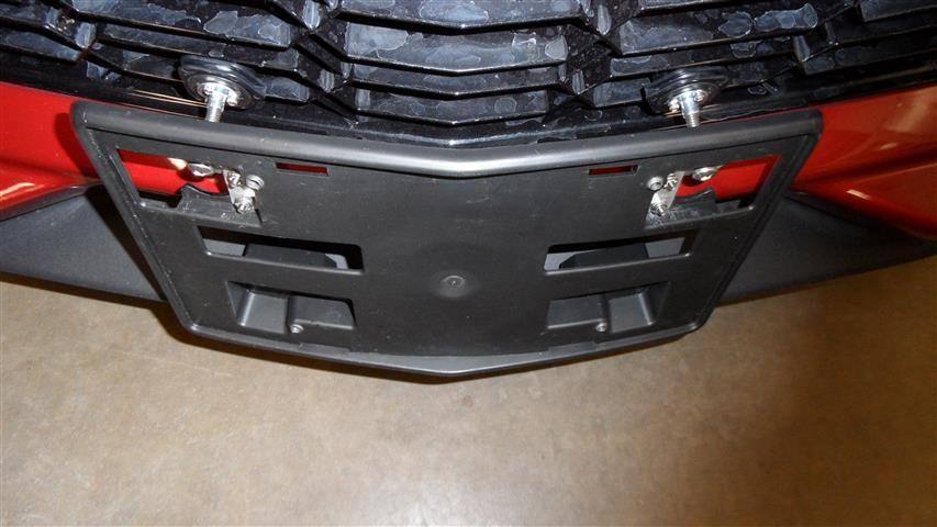

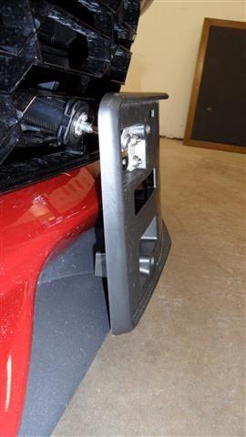

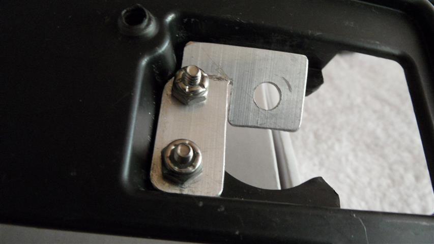

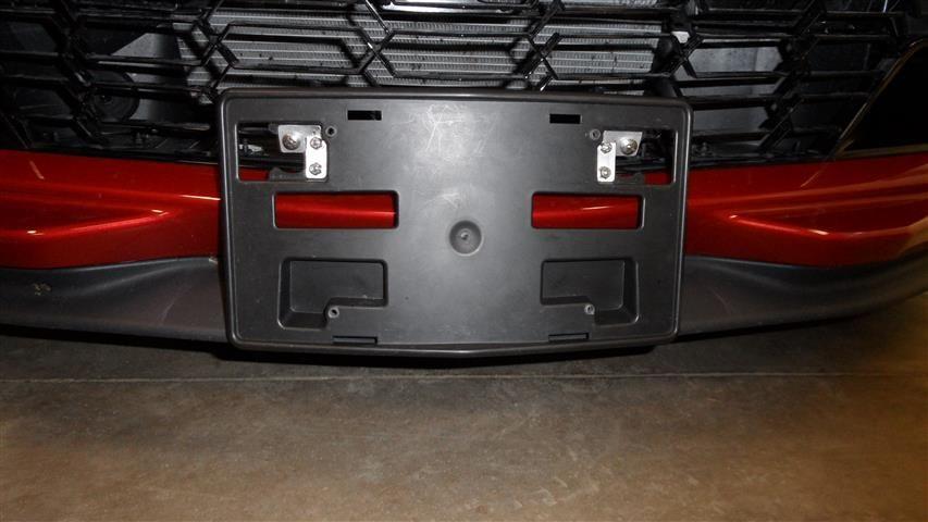

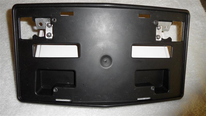

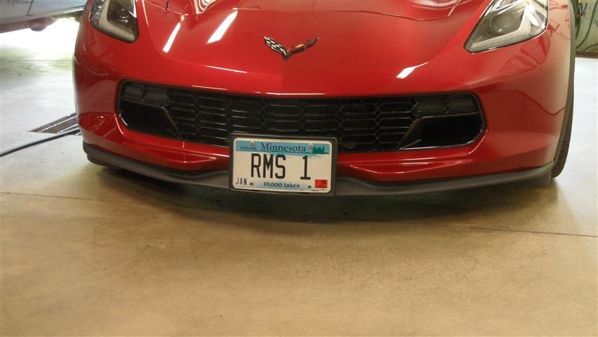

The two GM supplied options for front license plate mounting leave a lot to be desired. So I modified the in-grille plate holder and its grilled fasteners to place the holder bottom flush with the car's splitter. To me this looks a lot better and should minimize blockage of air to the radiator. I used SS hardware. The two main screws are 1/4x20 by 1 1/2" long. #4x40 used on the grille fasteners and #6x32 for aluminum brackets attached to plate holder.

Thanks for posting! I really like the way this minimizes blocking the grill. I saved the photos so that I can copy your idea when I get my Z06.

I like the way you used the stock fasteners to hold the plate to the grille..
Does it just rest against the splitter on the bottom?

how do you stop it from moving side to side, i did on my new 2019 G S
