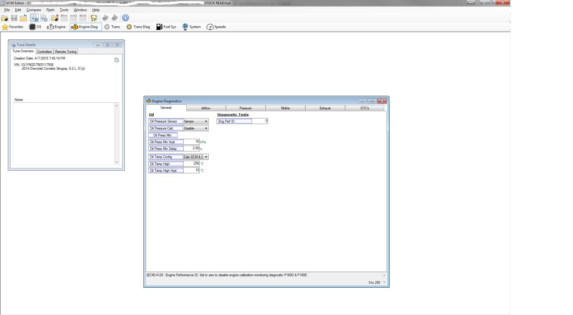

Likes: 152
Doug is obviously spot on as usual, however, if you need a visual I can send you a screenshot of what you're looking for.
Old Jun 1, 2015 | 06:04 PM
merican1's Avatar
merican1
Joined: Jun 2015
Posts: 20
Send it please. Can't hurt.
Old Jun 1, 2015 | 06:15 PM
C7BB's Avatar
C7BB
Joined: Mar 2014
Posts: 1,064
Likes: 152
This is just a screenshot of where to look. Easy fix.
