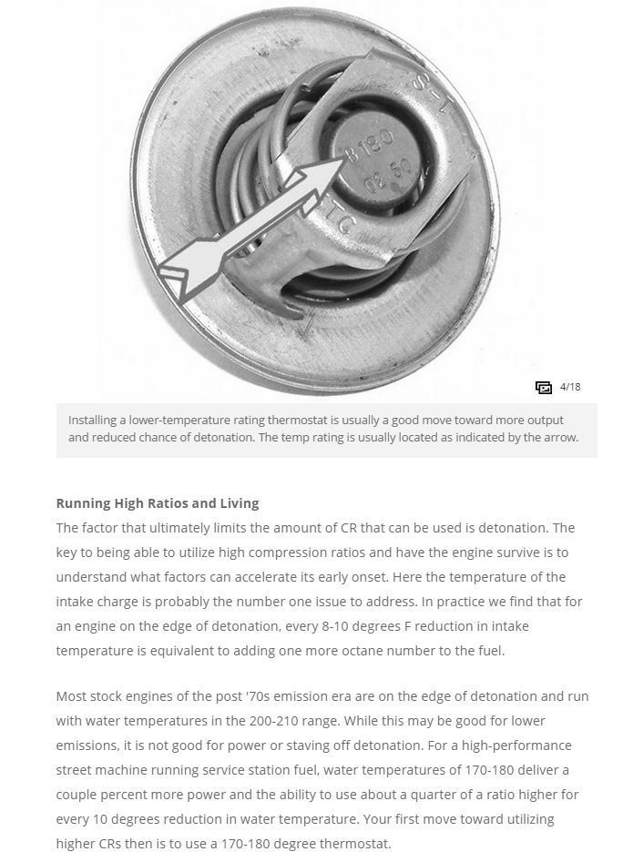

rolling the stock thermostat..
http://www.hotrod.com/events/coverag...power-squeeze/
