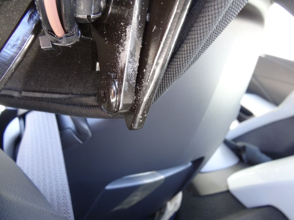

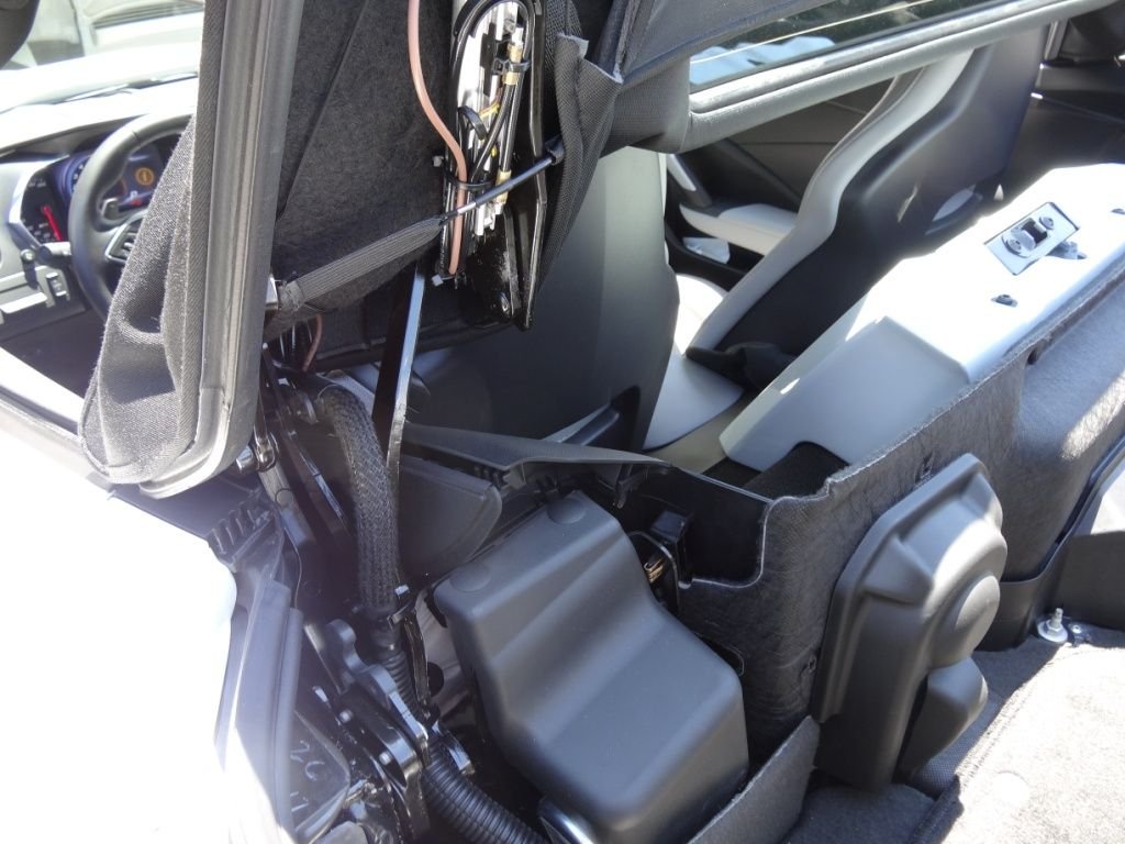

As I lowered the top and stopped the movement I noticed the driver side pivot on the soft top next to the speaker area showed scrape marks (white residue at the hinge). The hinge was being obstructed by the trunk liner which was causing an interference with the hinge. Looked liked the trunk liner (the vertical bend in front of the flat floor section) was not clearing the hinge. Basically, I bent the liner forward to prevent it from interfering with the hinge assembly.
The hinge was bending the liner down which probably misaligned the sensor. Basically the sensor thought there was something in the way...which was the car's own liner.

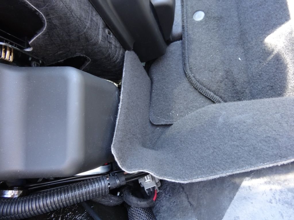

Floor liner was impinging on the hinge. (This picture is after I fixed the floor liner). Don't have a picture of the problem itself, the vertical part of the floor liner was bent almost completely to the floor liner's flat section.
Shows shavings of the floor liner plastic
I fixed by bending the floor liner to the vertical position and hooked to the speaker plastic enclosure

I can't visualize what you're describing at all. Any chance you could take a few pics? I'm also wondering how an issue on the driver side caused interference on the passenger side window.

So, I started the car while I stood behind the door opening and used the key fob to lower the top down and intentionally stopped the procedure half way, about where my picture shows the floor liner and the hinge. If both sides of your floor liner is not bent, then it may be a different problem. But if it is like mine, problem easily fixed

Thanks for the pics. What you wrote makes sense now. I'll check out mine this weekend, although the window problem seems to be getting less and less frequent.
