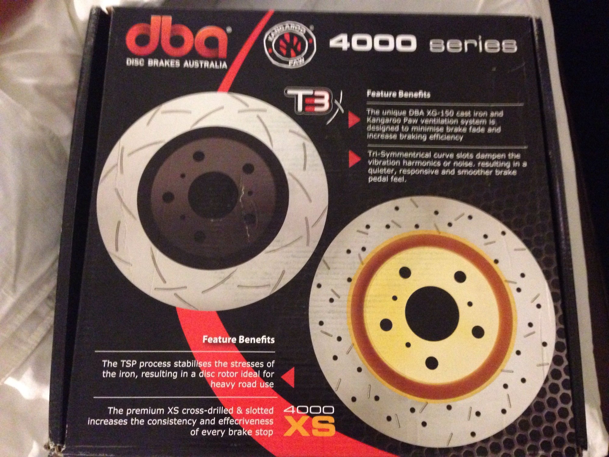

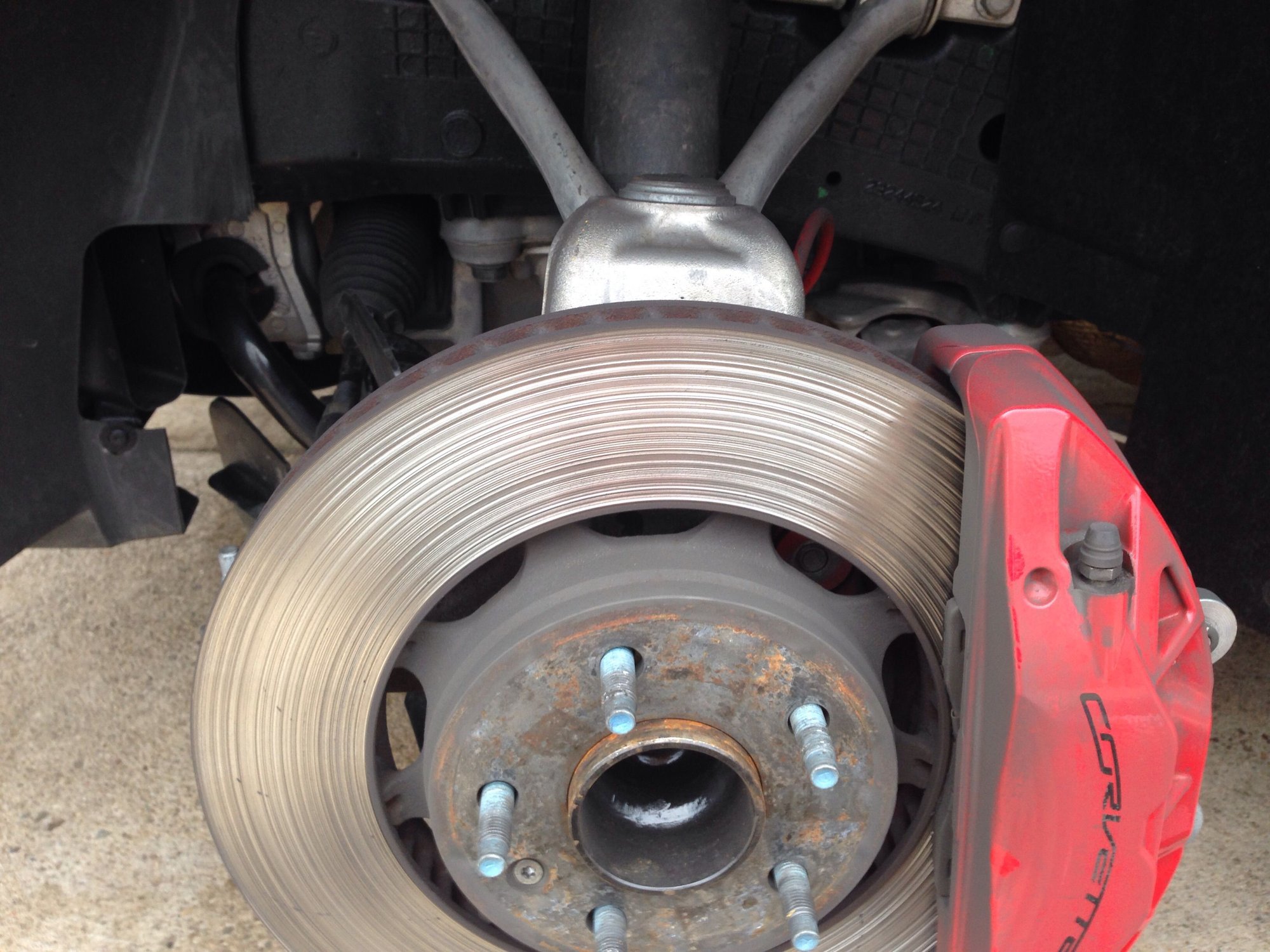

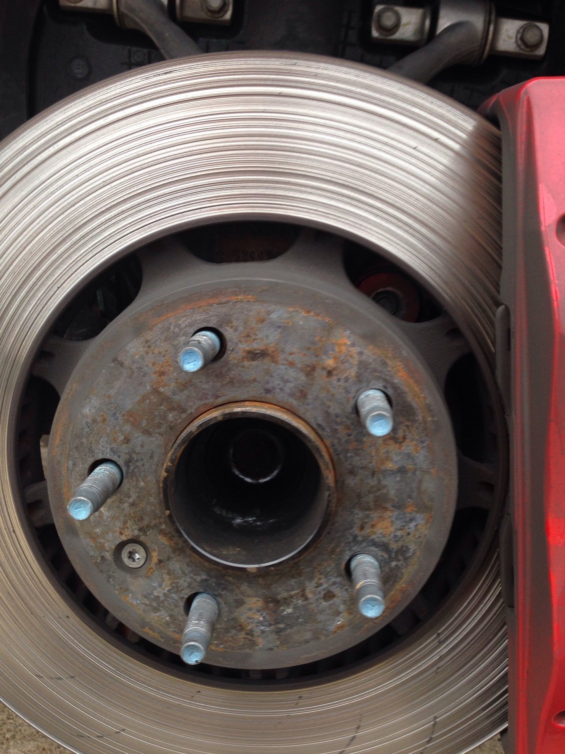

I wished I would have checked the thickness of these when I changed them, FYI they were true till the removal ( never warped) if I did not have a NCCC event at ponoco next week I would not have changed them, also I needed to find a rotor to stand up to my hawk streetrace pads, so far the DBA's are working .
Z51 rotors are soft!

nah, that'll buff out..
What DBA's are you using?
T3 , not the XS's
