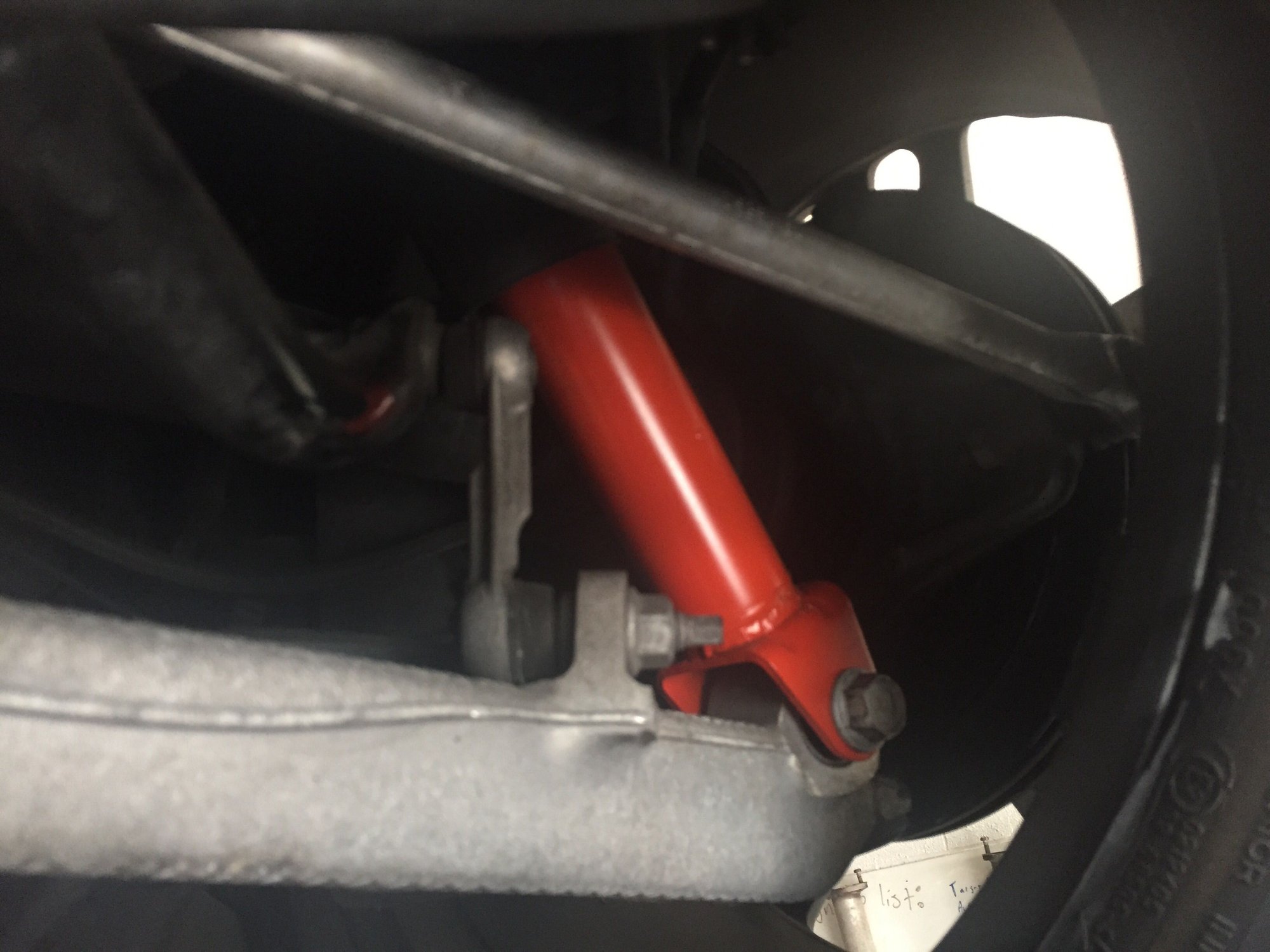

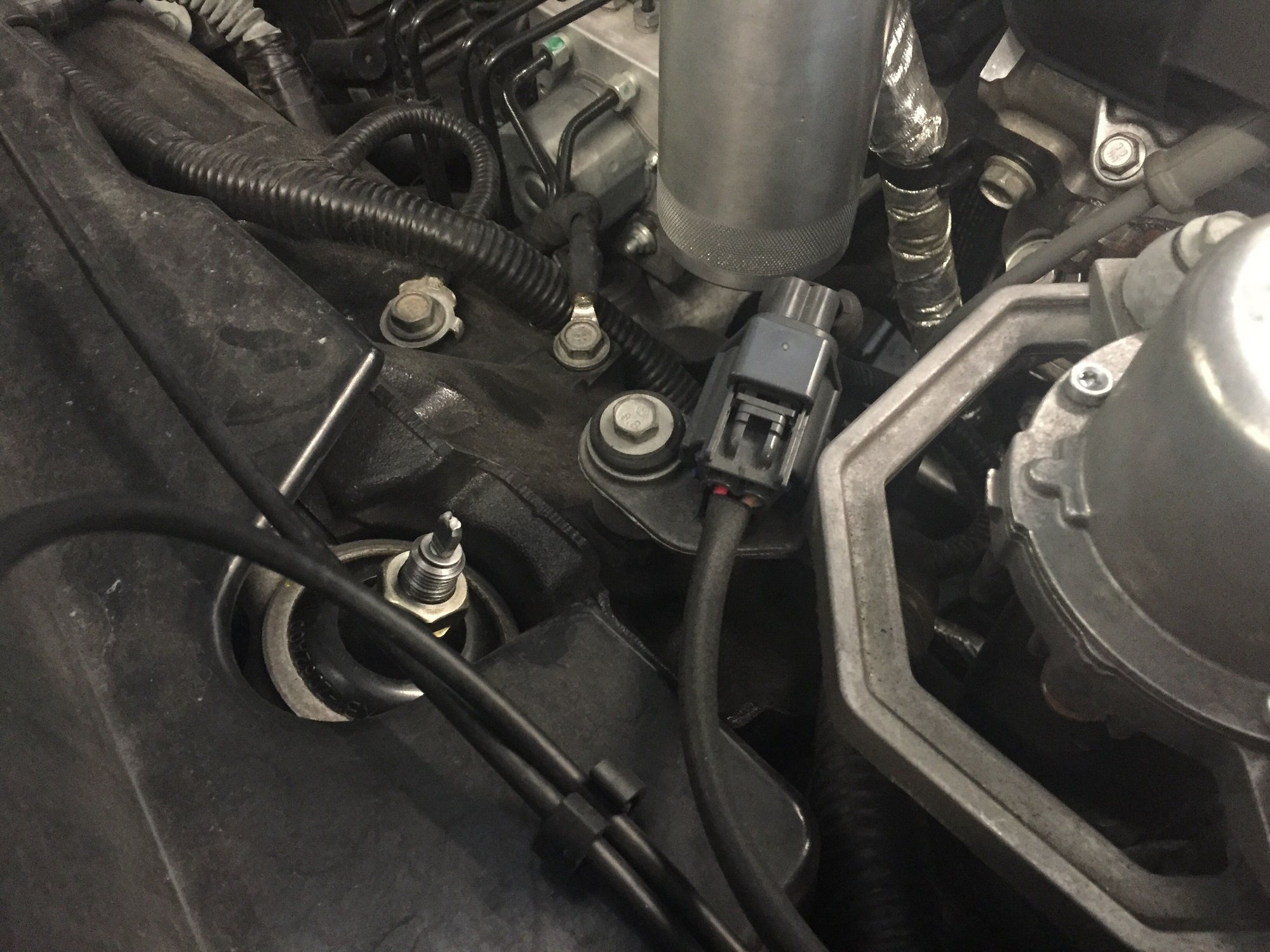

Apparently it's fairly difficult for me, as I messed up one of the top mounts in the process. An update:
Koni responded and apologized for my boxes not containing the addendum leaflet. It explains the tops need to be drilled using a 12mm bit.
I overheated the sleeve and surrounding rubber on my first attempt. The sleeve spun out as the rubber/bond melted. I used an air drill, I think I went too fast and didn't use cutting oil. I bought one new top mount, used a variable speed drill, Irwin cobalt bit, and cutting oil. I got through all 4 in about 15 minutes. It all bolted on perfectly after that.
The Good:
The damping feels much improved. There's significantly less compression damping, so the ride is magic. The overall motion is almost over-damped, but makes for a very confidence-inspiring drive. I am anxious for the next autocross to see how well they work in that environment, and will report back.
The Bad:
The shock bodies are slightly longer. This makes for about 1/4"-3/8" less bump travel at the wheel at the point the shock body touches the bumpstop. Modifying the tops to install them make reverting an iffy proposition. The tops aren't available by themselves (that I could find). I haven't figured out how to adjust the rears without removing the shocks. Koni includes a special adjuster, I probably haven't tried hard enough. The C4 was in the same boat, I'm not terribly concerned about it.
-michael
