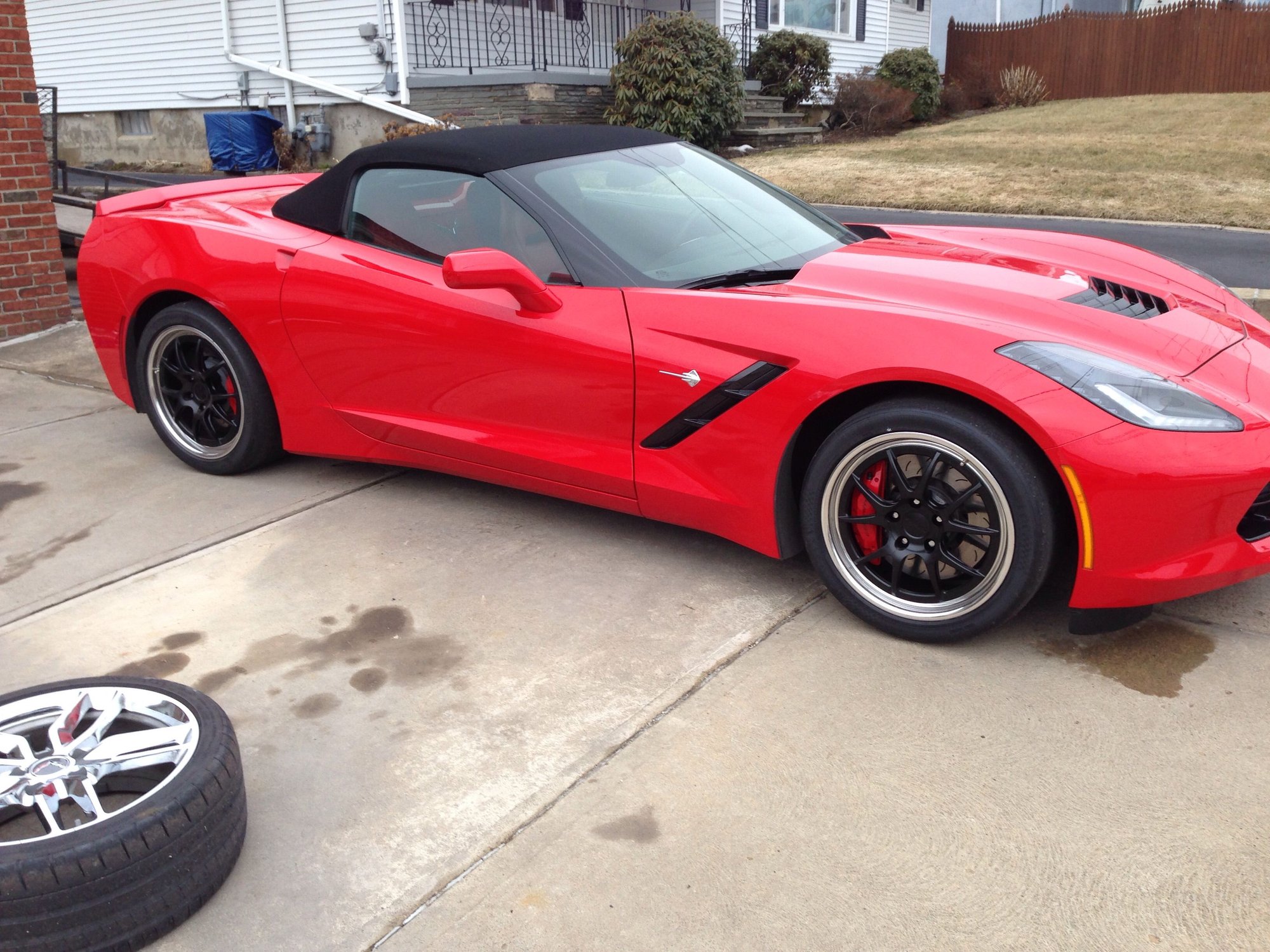

I track/autocross with many guys that use a 9 1/2 wheel for 315 Hoosier, but it seems you want 18x11 so here you go, the yellow rears are CCW and black rears are forgeline, both are 18x11 not your offset but as they say, we can do that!

[QUOTE=savage;1590386876]I track/autocross with many guys that use a 9 1/2 wheel for 315 Hoosier, but it seems you want 18x11 so here you go, the yellow rears are CCW and black rears are forgeline, both are 18x11 not your offset but as they say, we can do that!
[IMG]https://cimg2.ibsrv.net/gimg/www.corvetteforum.com-vbulletin/2000x1504/80-
QUOTE]
I appreciate your input. That gives me two manufacturers I can contact. Am currently working with another manufacturer, but their inner wheel design may preclude them making what I want, due to brake/wheel conflict.
The reason for wanting to go with the 11" width is Hoosier recommends it, as their experience is loss of optimal grip on corners, as well as wear. I can buy the grip and, possibly, the wear with the outside edge going too early.
Thanks very much, Jeff
