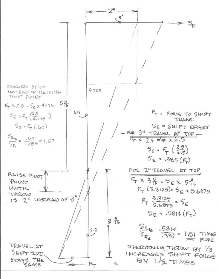

Looks to me like the MGW lower shifter box mainly makes the upper part of the box thinner so the shifter can sit lower, but the geometry of the shifter lever still has to be the same between the shifter rod and the travel of the top of the shifter lever..
The transmission shift rod force stays constant, so even with zero friction, if you shorten the throw, there will be an increase in shift force at the top of the stick.
It all comes down to geometry and physics...
Here is a quick analysis of the relationship between the pivot point and the force required to shift...
With a good compromise of at stick 6.5 inches above the pivot point, and a throw of 3 inches, if you shorten the throw to 2 inches (1/3) then the shift effort increases by 1.5 times.
If you shorten the throw by shortening the top part of the stick (by about 2-3/8") instead of raising the pivot point, then the shift effort is about 1.57 the 3 inch throw, essentially the same.

I would consider the increase in shift effort to be pretty minimal. I have no trouble getting into 5th gear. I have not had the opportunity to get into 6th or 7th gear yet. I would tell you that the decrease in stick vibration, more positive feeling shifts and shorter throws far outweigh any additional "force" required. Honesty, any additional force is really not perceivable in my opinion.

The effort is slightly more in my opinion but I like the more positive, bolt-action of the shifter. I agree that hitting third and fifth are much easier to get into vs the factory shifter.

I'm not even sure I would say the effort is increased over the stock shifter, because the action is much smoother, and much more precise. I can't imagine anyone regretting the purchase.
