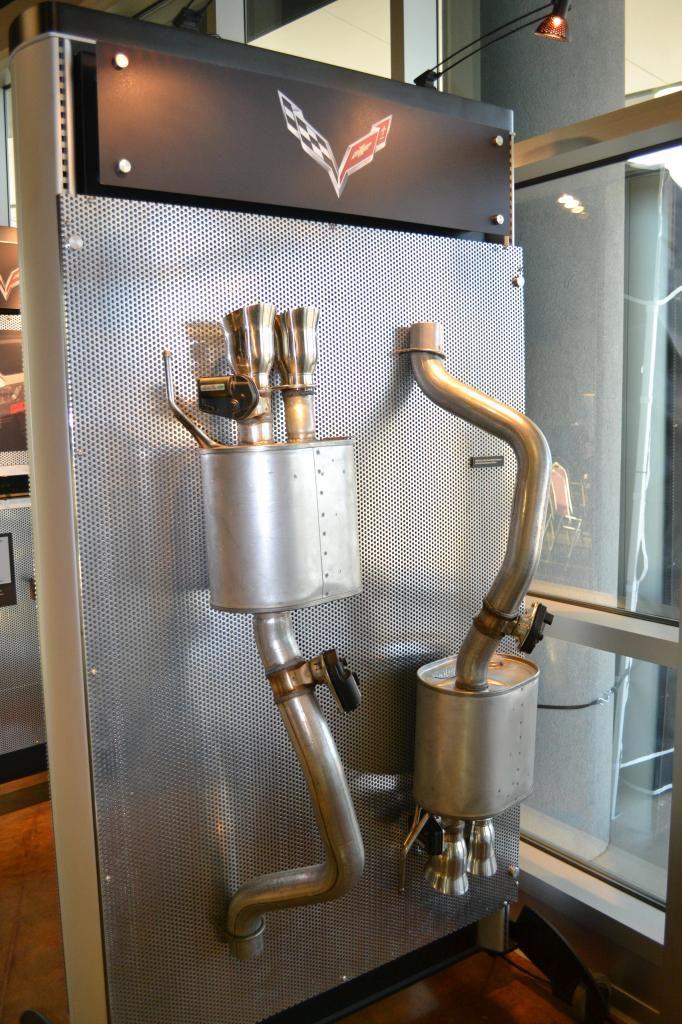

Great info on the codes but the "cylinder deactivation exhaust flow valve" are the AFM actuators that are attached to the axle back the OP has from Magnaflow.
This essentially confirms it's the AFM actuator (or stuck/sticky valve), and more specifically it's whichever side "bank 2" is.
In the photo below, the AFM valves are ahead of the muffler, and the NP valves are in the exhaust tips.
