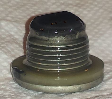

Did it look like this?
I had the same deposits on the fill and the drain plug..

Yep. Very similar
