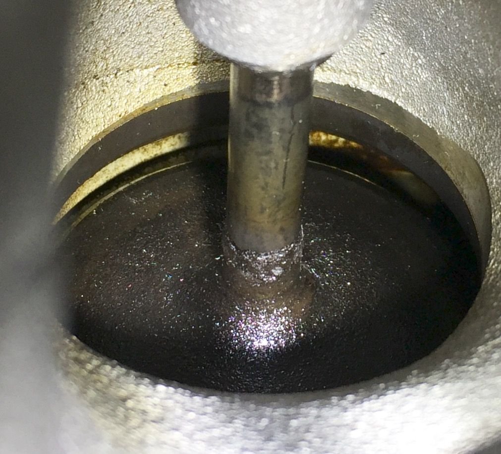

I swapped my intake manifold for one I ported so I took a photo of the valves. This is the clearest picture I was able to get. Notice the small lumps around the base of the stem. This is the start of coking. The car is 12,000 miles on it. The oily sheen is the CRC intake valve cleaner that I sprayed on the valve before I took the picture. Pretty good pic for an iPhone.
At around 5000 miles, I noticed a significant amount of oil from the Z51 dry sump tank puked into the intake manifold. I suppose this relates to the fact it was over filled. I installed an RX catch can about 1000 miles ago so it should reduce the oil going into the intake. The engine never shows that it's low on oil. So it's not burning it and I drive it pretty aggressively. No track time. Car runs great.
Do you plan to clean the intake valves using CRC intake valve cleaner to see if it removes the carbon build up?
BTW, is your catch can actual catching oil and other gunk?

Yes, I use CRC Intake valve cleaner. Yes, the catch can is catching oil.
