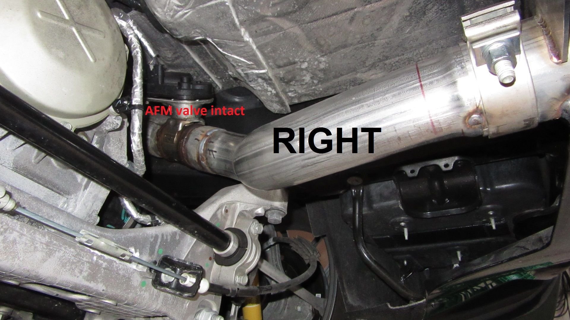

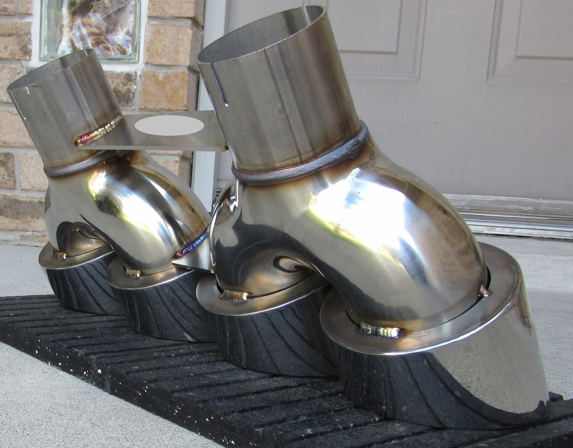

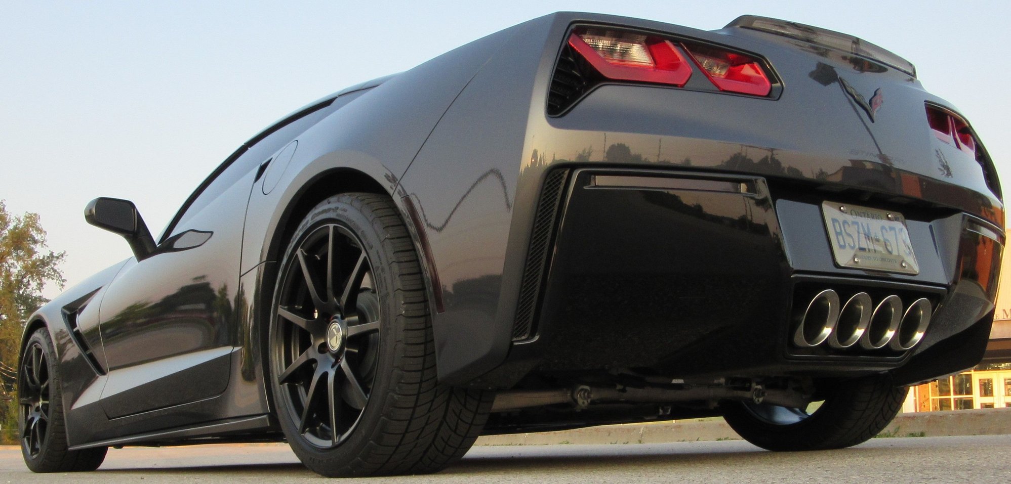

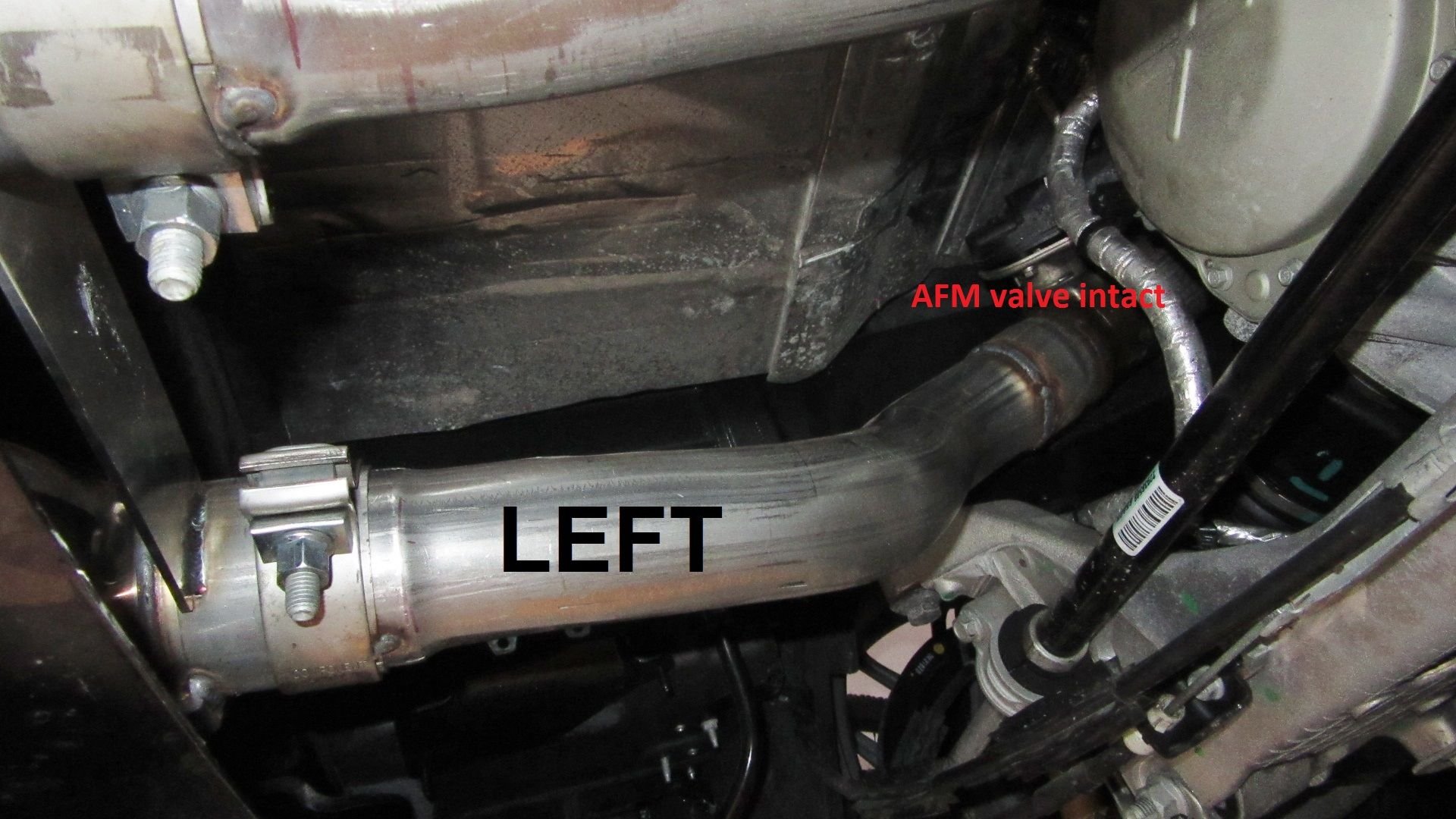

I am running NO MUFFLERS and Flowmaster quad 4" tips made especially for the C7
True on my C5 and C6 I could not run it mufflerless as it was too annoying
However the C7 with 4 cats it is not tractorish at all without mufflers---I have stock ported exhaust manifolds
It is just louder than a C7 with the NPP opened---aggressive on start-up but quiets down greatly after it warms
While cruising on the freeway ?? Wonderful---No resonance can still hear the radio and the phone easily and can still talk to the passenger
When going to WOT---It sounds amazing----No flowmaster deep rumble tone--Sounds more like a Ferrari or hi dollar import supercar-- More of a throaty race car sound
Total cost------$150 installed

I took it to my local muffler shop---They made short transition pipes from where they cut the mufflers off ( just ahead of the AFM butterflies) to the inlets of the quad tips---Sort of a S bended pipe only about 12" long--Then welded on the Flowmaster dual quad 4" stainless tips-----It looks factory---Then bends were mild so no need to have mandrel bends done---The inlet pipes are 2 1/2"---
Took them only 1 hour and they look great--
PS: I sold the stocks mufflers for $350 and total cost of the tips and install was only $150----So I netted $200 on the deal----And bought my catch can !!!
