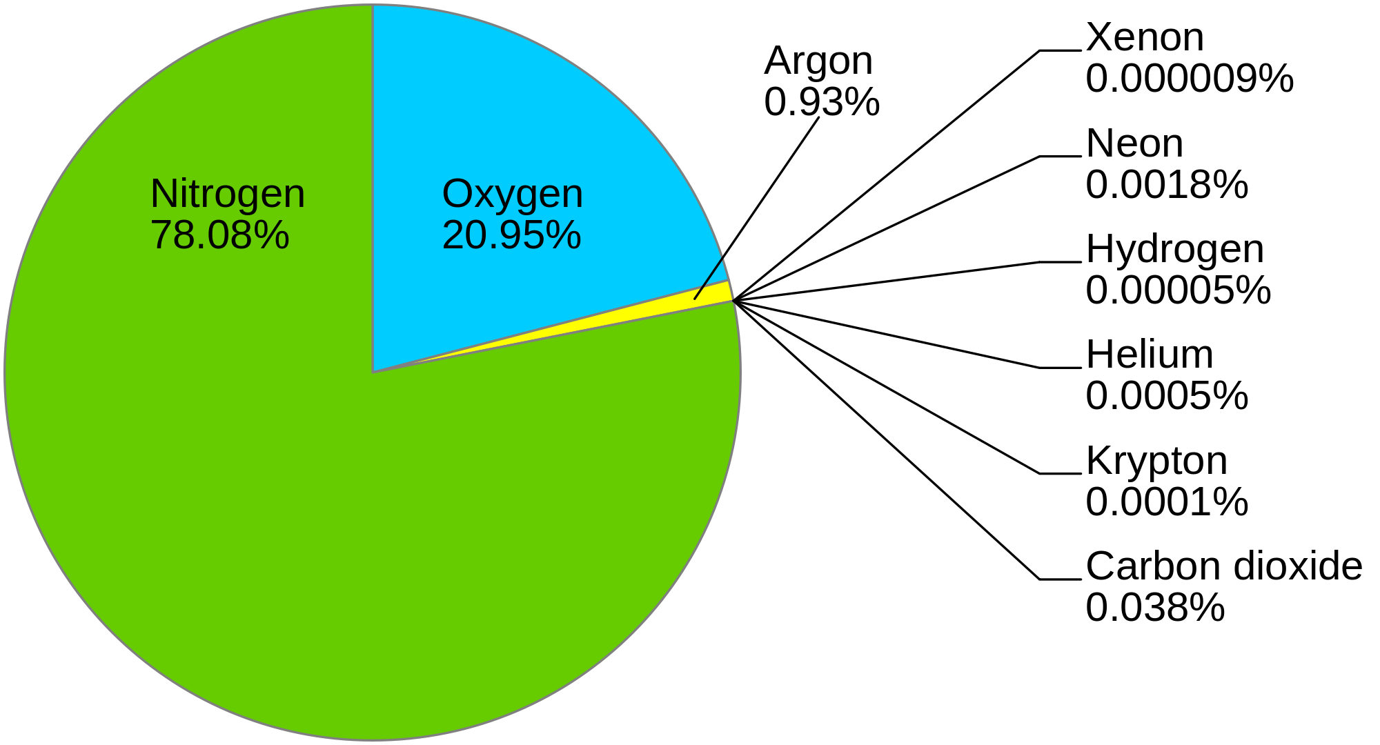

Google is your friend;
Before you criticize another's education, you may want to present actual science rather than a SPIN on it by the Get Nitrogen Institute. Your quote came from here:
http://www.getnitrogen.org/sub.php?v...eratureeffects
As Bill has already pointed out, read a bit about the ideal gas law below (an enhancement/combination of Boyle's Law). There is no difference between gasses in how much a given volume of gas (any gas, or mixture of them) changes pressure as a function of temperature. I didn't make this up. Much smarter people than me did.
https://en.wikipedia.org/wiki/Ideal_gas_law
The differences you are experiencing (as Juan said) has to do with the humidity in the gas you are filling your tires with reacting to the temperature change. It's not the difference in how much nitrogen vs. air (it's already 78% nitrogen) expands or contracts vs. temperature.
So the SPIN from the Get Nitrogen Institute relies on the fact that stations who fill your tires with it will have the proper de-humidificaiton equipment in place to deliver you "dry" nitrogen. On the other hand, the same equipment delivering similarly "dry" air will have the same pressure "stability"... It's the ideal gas law at work. However, I suspect this still may not convince you.
