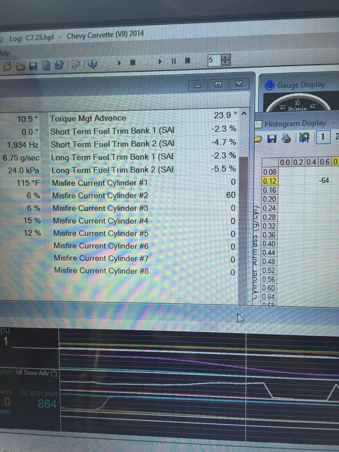

i installed Texas Speed Headers w/ X-PIPE. Recently tuned by Formato, I changed out cylinder 2 'wire' and 'spark plug'..) fixed a stubble problem i had ) now its misfiring agian in 2 and other cylinders. Issue is its misfiring other cylinders now and at WOT is pops and stubble agian.. Could headers cause this? or maybe change my spark plug wires to Taylor brand and put heat protection wires on them?
1) Can headers be shaking the spark plugs/wires to cause this misfire?? WOT it is causing the car to pop and break up.
2) Next step is stock tune, diagnose the vehicle see which cylinders are missing than take it in to dealership if its still missing.

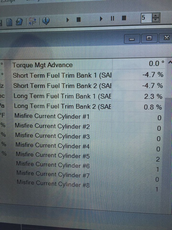

Hey I put in stock tune and still getting misfires. Headers are close to the wires could it be that or plugs cracked? Next step is changing out the plugs should I go upgraded or oem?
