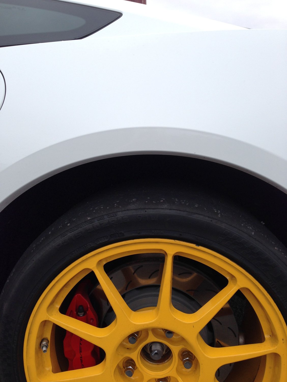

Have pic from the rear see how wiDE tire looks under the car abd how far sticking out of the fender....

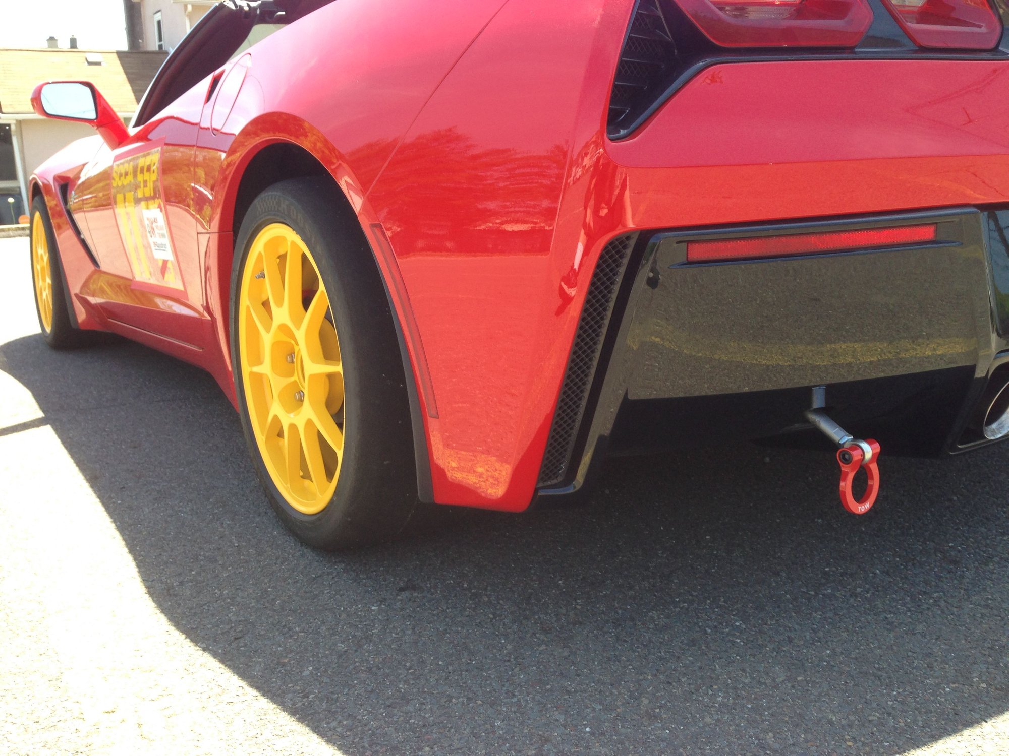

A 315 on a 78 offset does not stick out at ( will not break inner fender lips off) these are/ look out because it's picture day and I have a 3/8ths spacer on rear.

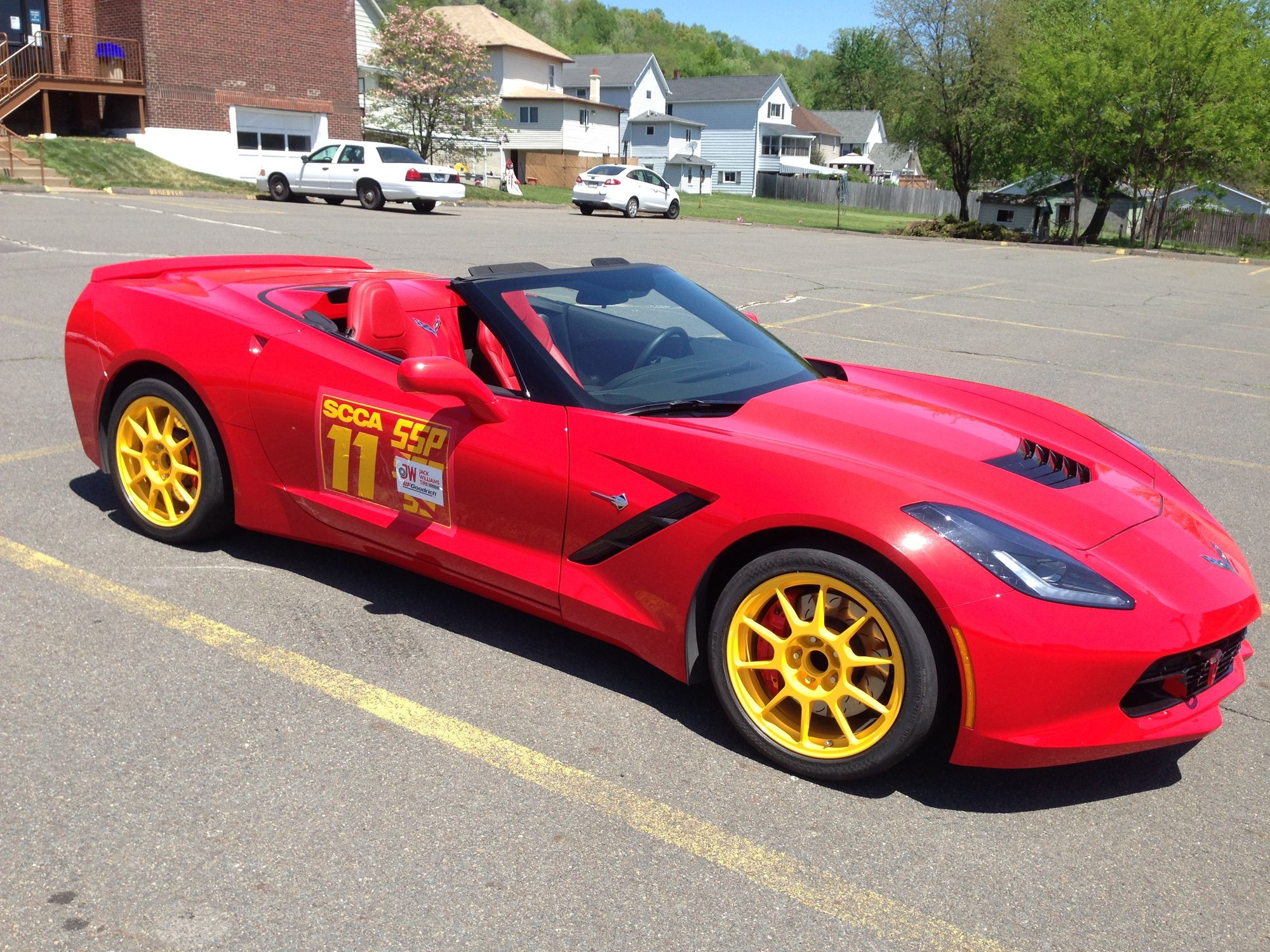

Here is same wheel without spacer on my new mag-ride car, my thoughts were to try a 335/30/18 back there but it's not worth the chance of damage, it does not take much to break off rear inner fender lips( they don't grow back)
