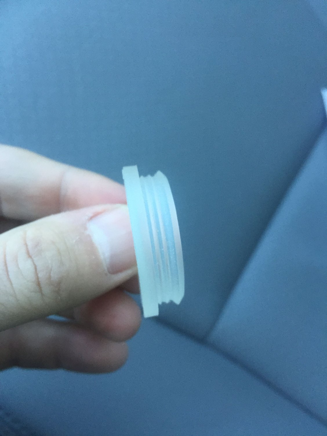

Originally Posted by C7&7
Much better looking piece right here. Part# 23484882 for just the grommet. $3 part:
Hoping that if I bump this you will see it. Mines leaking now too. Where did you get that part? I haven't disassembled yet but pretty sure its the same leak as yours.
The odd part is this seemed to happen while my car was parked for about 10 days. I went on vacation and came back to a empty tank. Put a little in there and put a paper towel down and checked this morning and I could see where condensation was on the paper towel right where my meth tank is.
yup mine happened after sitting also. I got the grommet at a Cadillac dealership in Dallas. Guess it's a similar part on the caddy.
The part number is above. Call me if you need to discuss or need help. 214.882.8271
