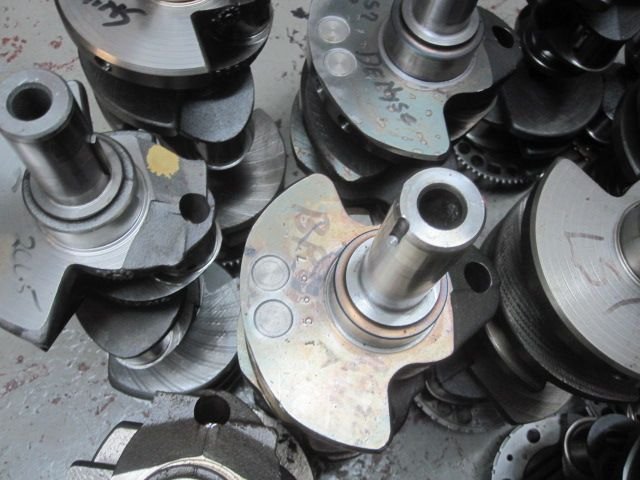

There is no benefit in lowering the Cg by adding mass other than to balance or dampen vibrations. Vette crankshafts are balanced with the stuff. You add lightness where ever possible on cars and aircraft.
