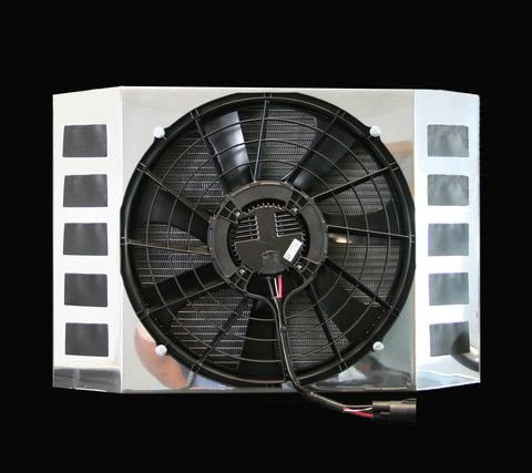

For whatever reason GM mounted the electric fan covering about 2/3 of the core face. The upper 1/3 is ducted up and out from the hood. This got me to thinking. What if we moved the fan up to cover all the core face, and eliminated the the duct. Now the fan will pull through 100% of the core, and ALL of the engine compartment heat would be pulled out through the hood vent, not just the portion that went through the top of the radiator. Seems like a better way to go.
If this doesn't work with the stock fan, we could create a shroud with a 17" Spal fan similar to this one.
I'd be willing to work with a volunteer on something.
