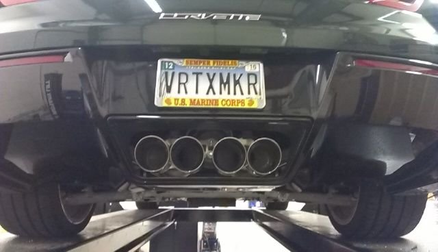

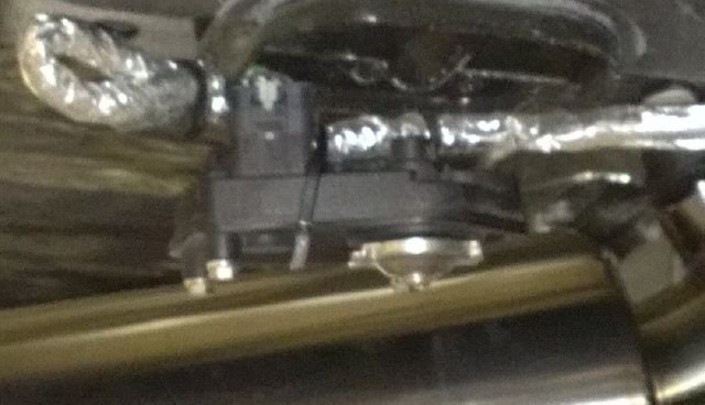

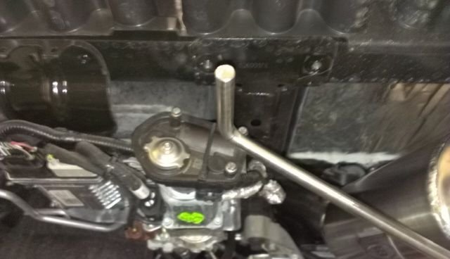

I installed Bullets in my '14 Z51, and if you have non-NPP's you should have no problem, whatsoever. If you have NPP, you can tie your actuators up to the frame like I did.
The Bullets do have a slight separation between the right two tips and the left two.

can you post pic? also how difficult was the NPP, because I have that?

I don't have a sound byte (Youtube has plenty), but they are significantly louder than the NPP, with a lower tone. They aren't as loud as Bullets installed on an LS2, 3 or 7, though.
The right actuator tied up.
The left actuator tied up.
