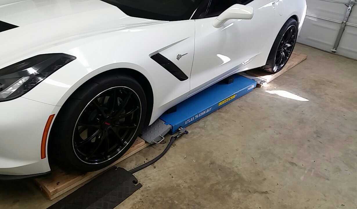

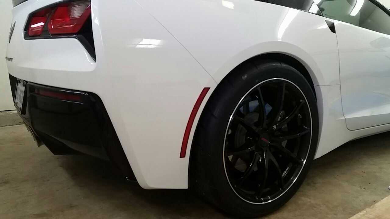

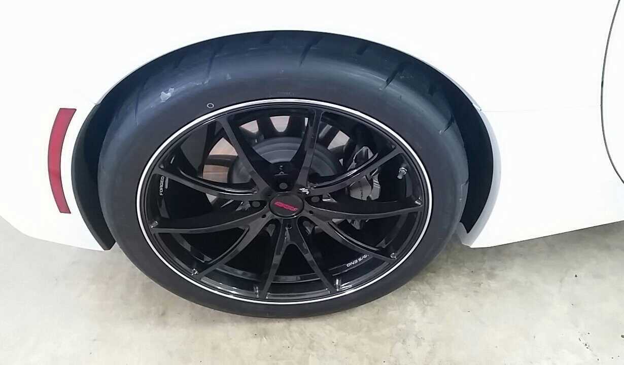

They just arrived--should have pics with them on the car in a couple of days. The front wheels are 18X8.5 and weigh 21 lbs. w/55mm offset. The rear wheels are 18X10 and weigh 22 lbs. w/79mm offset. They are available in black and matte graphite finish. I'm starting with MT ET Street SS 285/40R18's (29 lbs./26.9" dia.). If more traction is needed, MT ET Street SS 305/35R18's (33 lbs./26.6" dia.) will also fit the 10" rims.

Info is in my signature.

Looks awesome.. did u go more negative camber? I just mount 315 30 20 on my aftermarket wheels.. tires so fat its sticking out.
I need more neg camber?

Thanks. No, I'm still with OEM settings.
You should have more traction now! Good luck.

Your 3rd photo looks like negative cambered. Maybe its the photo angle.. I probably get 2 more 18inch wheels for drag setup.

What is offset of the wheels? I'd say that's the issue with them sticking out vs the camber.
