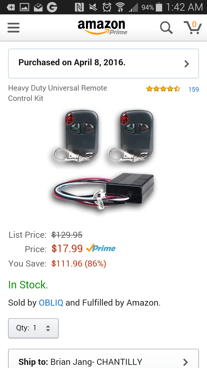

Originally Posted by !00%DISVET
What is the name of the line lock?
I got everything from amazon.
Line lock solenoid is JEGS brand

Originally Posted by Seannyc
How do I order this any site or anything
I got everything from amazon for about $100
Jegs line lock solenoid
Heavy duty remote control.
Jegs line lock fitting
Thread sealant
1/4 brake lines and few fittings and unions.
fuse holder with 5-10 amp fuse and some wiring.

Originally Posted by hqbrian04
I thought about wiring it to left paddle shift.MT(rev match)
You can probably learn the remote buttons to two of the visor buttons, with no extra work
I have the same remote for mild to wild exhaust. I have 2 remotes and only use one. Do if you know I can learn the extra remote I have for t he Line-Lock. Thanks syswayne
Old May 22, 2018 | 11:22 PM
only9balls's Avatar
only9balls
Joined: Dec 2015
Posts: 812
Likes: 192
I believe that it may be possible, but I haven't tried it. I know it was able to be done on the C6 Z06's with the homelink system, so I would think it should work.
