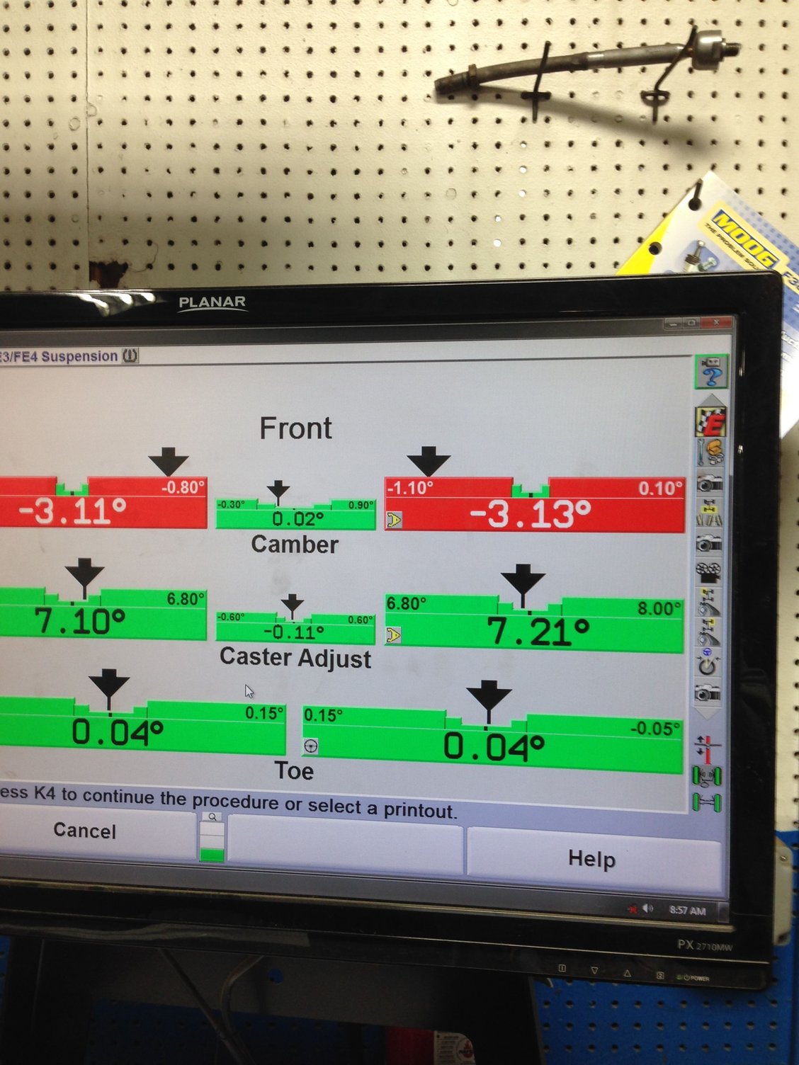

By the way, can we get those aggresive cambers without having to modify the suspension? I suppose I need to pull all the washers out of the upper cnotrol arm mounts?

Removing washers can get you more negative camber. I have a 27.2 tire due to running a takeoff 305 Pirelli slick. Computer acts fine and it works. I can run a 295 that's a 26.8/9 inch tall tire.

If you want neg camber you need to pull washers( it makes it so easy then) All removed from front, half from rear<br ><br > <br > <br >
