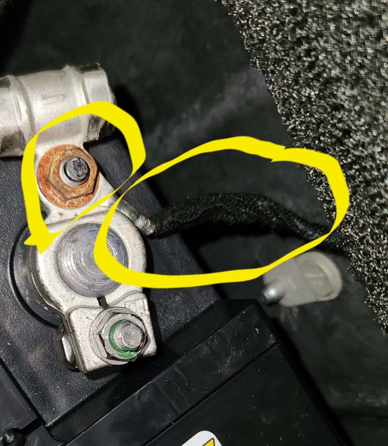

Originally Posted by kodpkd
And the little black wire?
This one? I just noticed the nut looks rusty. Odd nothing else in there is. Anyway, its very tight but i think ill take it off and replace it/ckean it.
What does that wire do? What happens if i disc it and reconnect? Will i have to reset something?
Old Nov 19, 2024 | 12:31 PM
kodpkd's Avatar
kodpkd
Joined: Jun 2019
Posts: 5,355
Likes: 2,104
From: Loveland
The black wire has caused issues with electronic problems on the C7,,,, good catch. Wire brushing clean and reconnecting should be good. Just a side note,,,, don't use dielectric grease directly on any electrical connecting points
The black wire has been an issue with electronic problems on the C7,,,, good catch. Wire brushing clean and reconnecting should be good. Just a side note,,,, don't use dielectric grease directly on any electrical connecting points
Will I have to reset something after I reconnect it?

From: Atlanta GA
Thank you
Not really but ...don't take any chances removing it with the power connected. Just remove the cables first before you remove the black wire to clean it . I had to repair mine after it broke .
Dave
Dave
From what I can see and test that small black wire goes straight up to the cigarette lighter style power outlet. When i took it off, I followed it straight up the side panel and put a meter on it and the outlet.
BTW it was completely ckean like new under the nut through the wire connector and connection to battery terminal. So no problem with any connection there.
Yep I did not think it was the cause of your problem but you never know . The black wire does go to the charge port in the back and it also spliced into the wire harness that goes to the ECM
