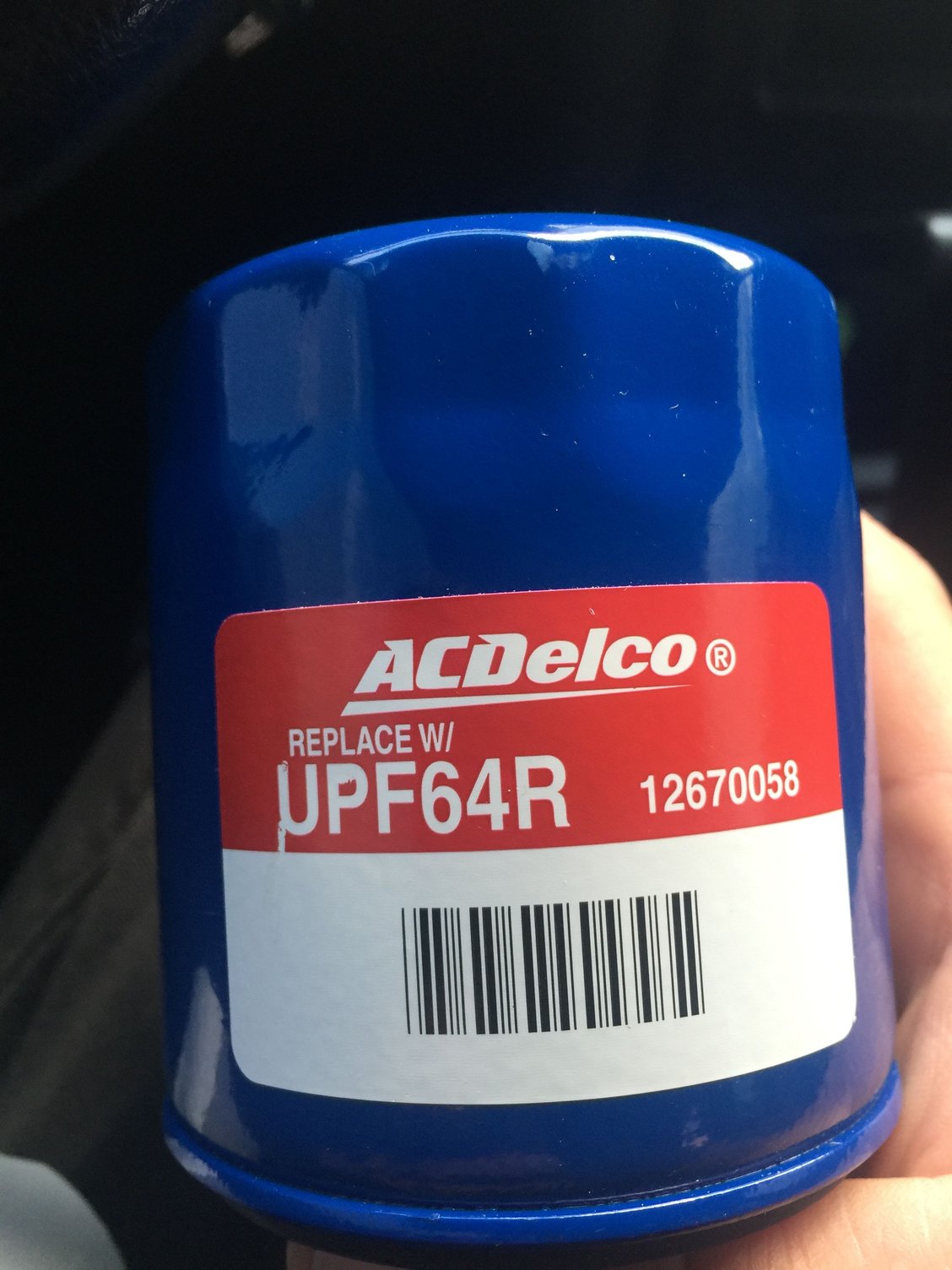

Up till today, the dealer had changed the oil on my 2014. Today, I tackled the job myself. A PF64 was installed in the car. I had to drive half way across the city to find that filter. Several sources indicated a PF48 was the needed filter, and did not stock the PF64. Perhaps this has been posted before, but a search did not find anything on it. Just beware to find your filter before you drain the oil - particularly if you live in a smaller town.

Pf64R is the best filter for your car, it's 13bux at your Chevy store

Compared the UPF48R and the UPF64R. Appear to be the same filter with the newer style base gasket found on the PF64 and UPF48R.
