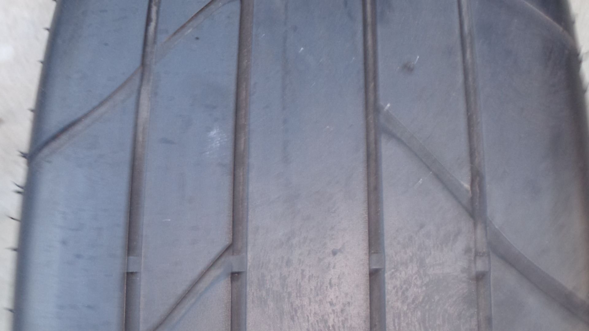

Would get the race star 18X10.5 they can be used with either size tires. Would go with the M/T's. M/T does not make my tire now and my rim is 18X9, I can still get some passes on the tires but getting close to the ware bar. The wheels I have recommends a 285/40/18 and have called M/M and was told it would be fine. The problem I may have is the offset with the 285's. I may have to get new wheels and tires next time. Here are my Discontinued M/T DR's.

I have the Race Star 10.5x18's with M/T 285-40-18's. They fit well and you can run the bigger 305 if needed.
Only 3 passes so far but my times did improve a full tenth to 11.93@120 from the stock tires.
IMO the M/T's will take some time to break in.
I stage mine the same way that C2367 does.
It takes seat time, just stay after it.
