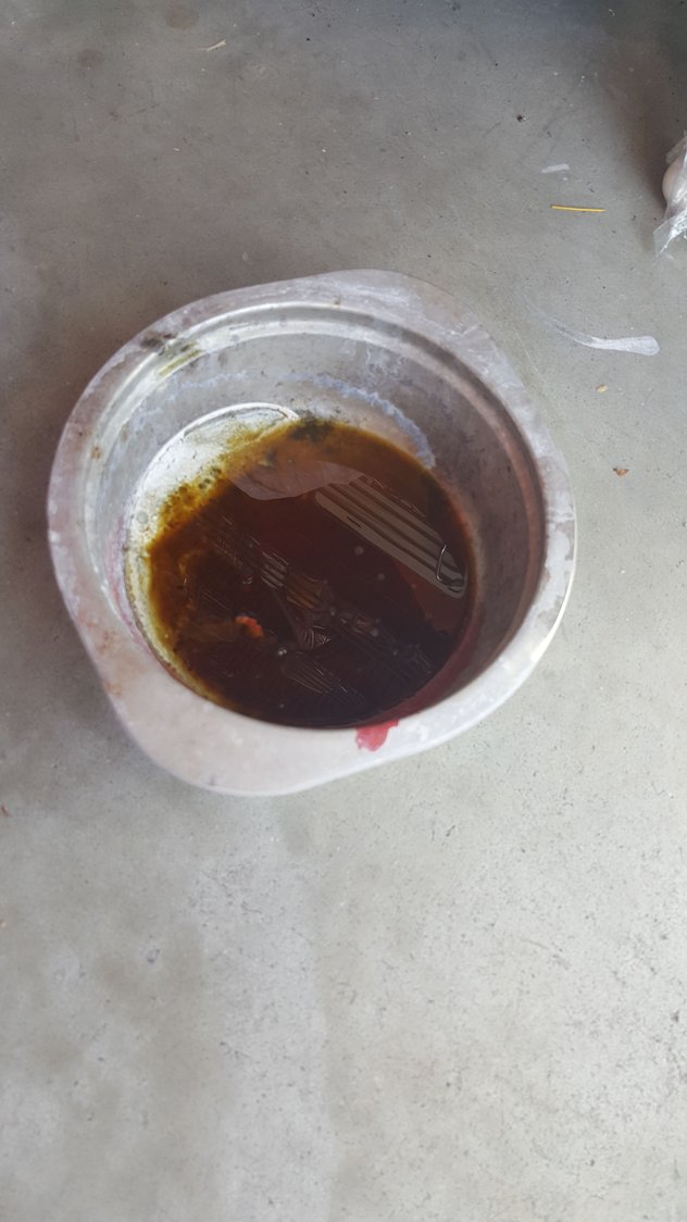

If you want crap like this going down your intake, be my guest...
