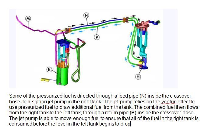

You could remove the inlet nozzle and siphon the left tank, but you will not get the fuel in the right tank since only a jet siphon pump transfers fuel to the left tank as fuel is used.
The fuel system is designed to empty the right tank first since the engine is supplied fuel from the left side only.
