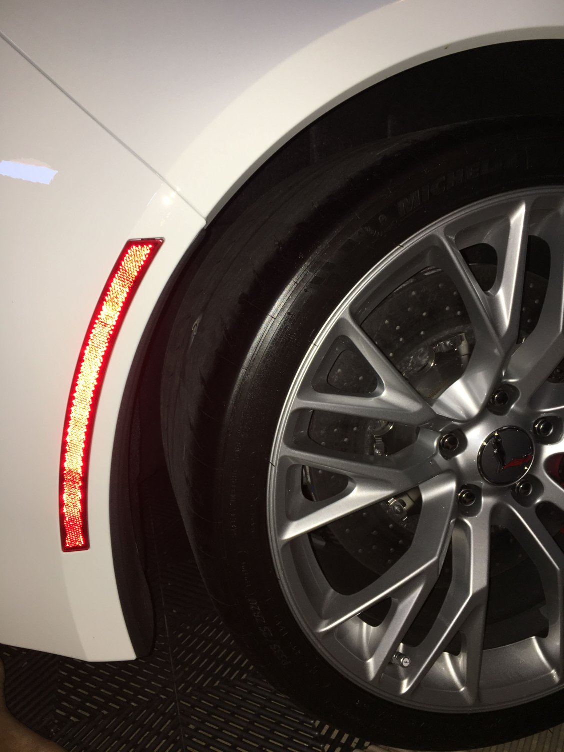

I have a 2016 Z06 Z07, which I got at the end of the 2016 run. Being a Z07, it has the Michelin Cup 2 tires. With just under 600 miles on them, the right rear has sustained a puncture from a pretty large bolt. It is almost dead center on the tire. Question is, are repairs to these tires safe up to the Speed Rating of the tire. My last experience with this was a '90 ZR1, and the tire shop claimed an inside patch was good for the speed rating of the tire. Expertise and experience appreciated.

If repaired correctly by a qualified person it is good to the speed rating. Did the tire lose all air pressure? How far and how fast did you drive on the tire after the puncture? If you went over 50 mph or over 50 miles the tires can't be repaired.

Good to know. I just took delivery of a 2019 Z06/Z07 and with less than 60 miles, I picked up a nasty screw/nail in the passenger rear tire. I had just picked up the car from my local body shop where I had a custom hood stinger painted on so I probably picked up the nail/screw near the shop as it's located in a pretty industrial area. I was out of town on business last week when I received an Onstar email informing me the tire pressure had dipped to 17 psi. When I got home, I inspected the tire and found the nail/screw. I have a set of Forgeline AR1s and Pilot Super Sports I plan to mount on the car, however I was planning to run the OEM wheels/Cup 2 tires for the first few weeks to get a better feel for them.
It's good to know these tires can be patched so the plan is to remove the wheel/tire and bring it into my local tire shop for the repair.
