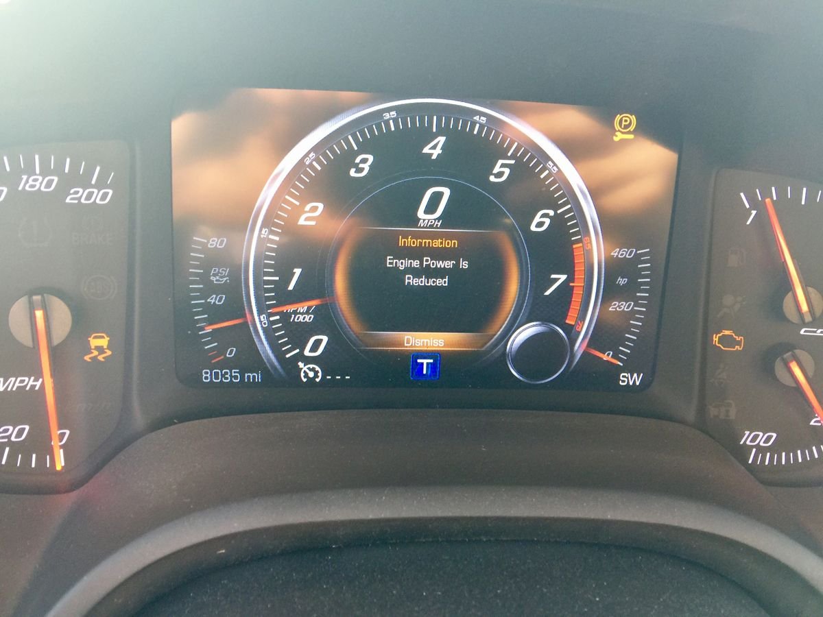

Hi all.
Car is a 2016 Stingray. I installed a Vitesse Throttle controller back in May/June of last year. Worked great for a few months. Then I started having issues...occasionally at first, then progressively more frequently, to the point where I had to unplug the controller back in early November.
The controller makes the car go into limp mode. I bought a second one, hoping it was an issue with the controller. Plugged it in, and immediately had the same issue. Unplug it, and the problem goes away.
Has anyone had this issue before? I wrote the guys over at Vitesse with the problem back when I was hoping it was limited to the controller, but now it's pretty clear it isn't the controller in itself that's causing the problem.
I'm getting the traction control, parking brake, check engine light, engine power reduced message, and check engine lights.
Your thoughts/suggestions are appreciated. Thanks in advance. My apologies for the really bad cameraphone image.

a couple of issue fixes learned from reading in the C6 forum:
make sure calibration is performed correctly and accurately. Many issues fixed with a proper recalibration.
Also, ensure the module is placed away from heat and other electronic devices.

I haven't tried recalibrating. I didn't consider the unit would just forget its calibration. Thanks for the suggestion.

I've had mine for over a year and, recently, I noticed I was getting throttle hang when I first started the car. A quick recalibration fixed that. Vitesse says needing an occasional recalibration is normal. It only takes a minute so nbd. :thumbs Oh, and it's definitely worth it - awesome mod. I go into withdrawals immediately when I turn it off.

So to update...just plugged it back in and re-calibrated it, and it's working fine.
My first one must have gone out of calibration. I posted a thread here back in September about it, and got a lot of good responses, but I had gotten busy with the sale of my business and this slipped through the cracks.
When I installed the new Vitesse Throttle Controller a week or so back, I forgot it had to be calibrated, so the limp mode symptoms were my fault for forgetting that.
