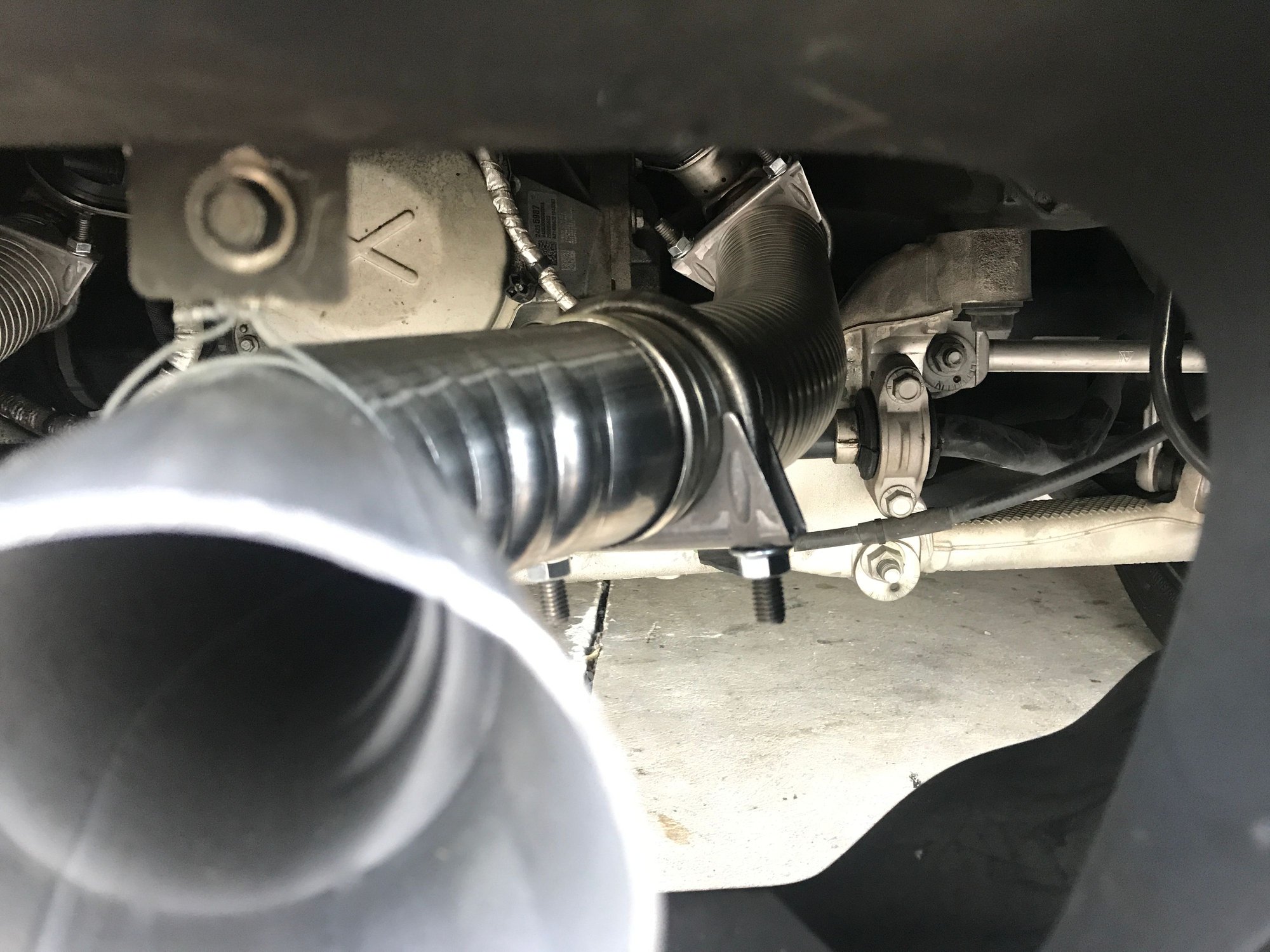

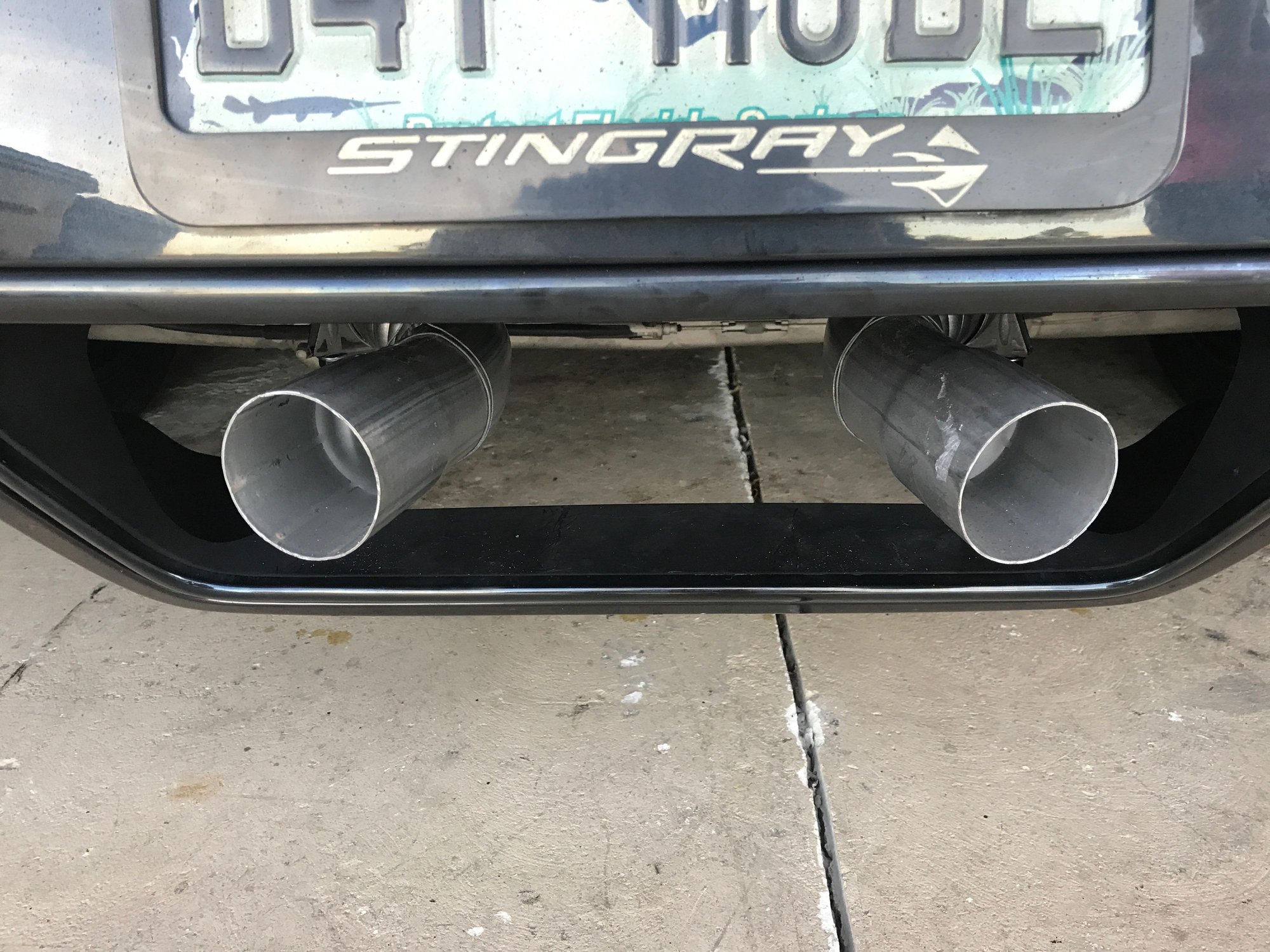

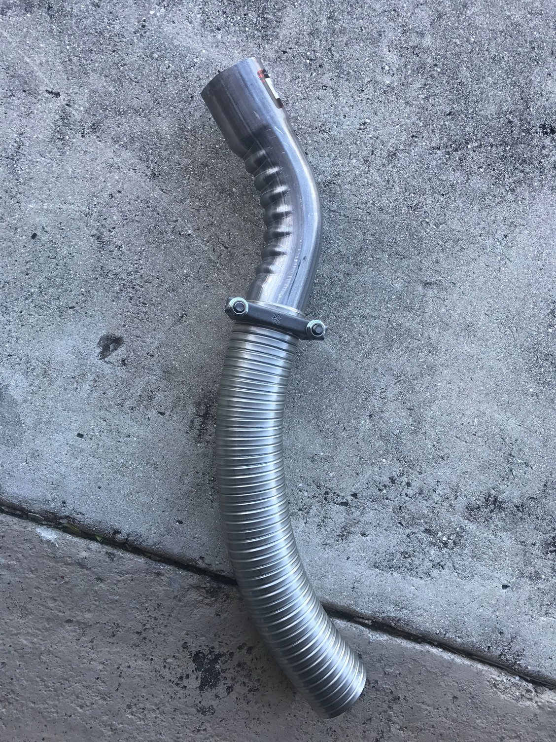

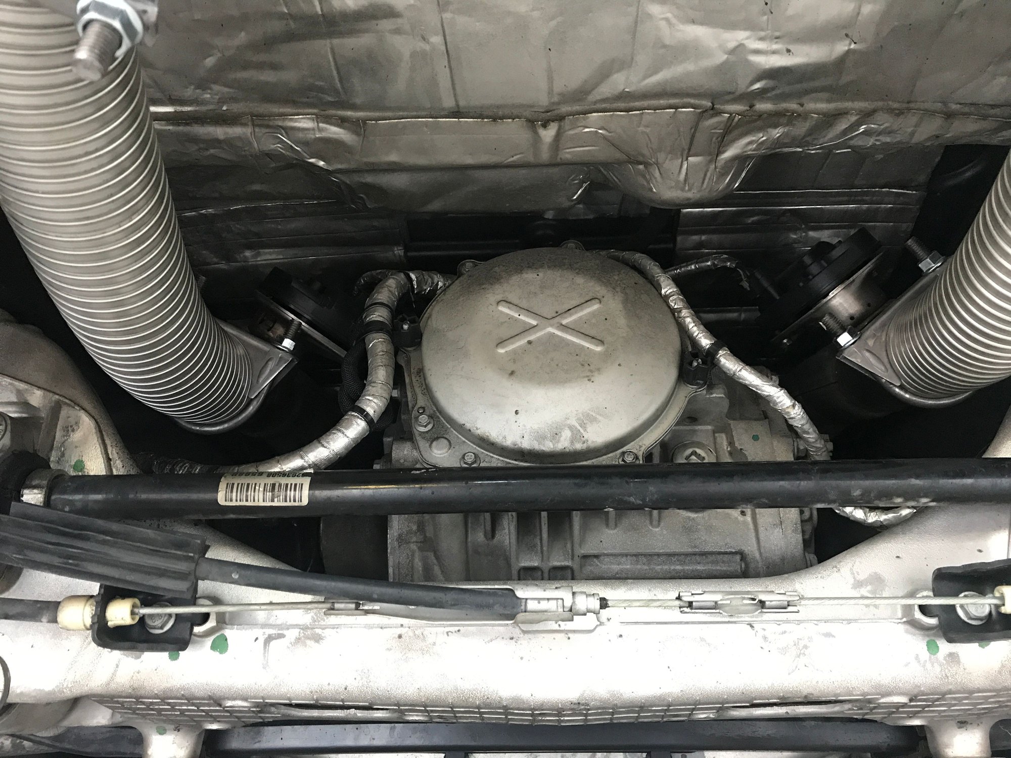

Ok so last sunday at our track rental, I blew my Corsa exhaust off when doing a run. It basically decoupled where the over axle pipes meet the mufflers on both sides. Maybe I didn't tighten the clamp enough. I ended up taking the mifflers off the car while at the track so I could drive it home. I decided to spend $35 at the parts store (Advanced Auto) and bought some exhaust flex pipe and some adapters and basically "made" a straight pipe setup for now until I figure out what I am going to do permanently. I'd like to do the Hooker Blackheart Z06 axle back without mufflers. But those are $900+ . At least they are stainless and are 3".
So heres what it ended up looking like LOL. It actually sounds a lot like NPP exhaust with the valves open to me. Funny thing is I took it like this to a dyno day yesterday and got second highest HP of the day at 850HP on a mustang dyno lol. Everyone got a kick out of the exhaust haha.
Laugh all you want! Car is fully driveable for now until I make up my mind on what I am doing permamently LOL
