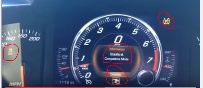

It's two clicks. Wait 1-2 seconds between clicks. I don't remember what the DIC display is tho. I'm not able to search right noow, but I think there's a Youtube video that shows it.

DIC says competitive mode for about a second and message goes away.
Edit: its two clicks, first is traction control off then stability control off. Watch the dash, both will illuminate in orange when they are off. Then competitive mode displays in DIC and disapears.
