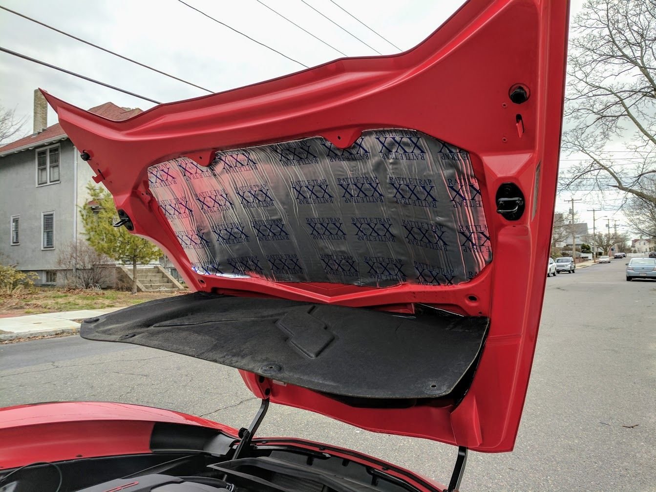

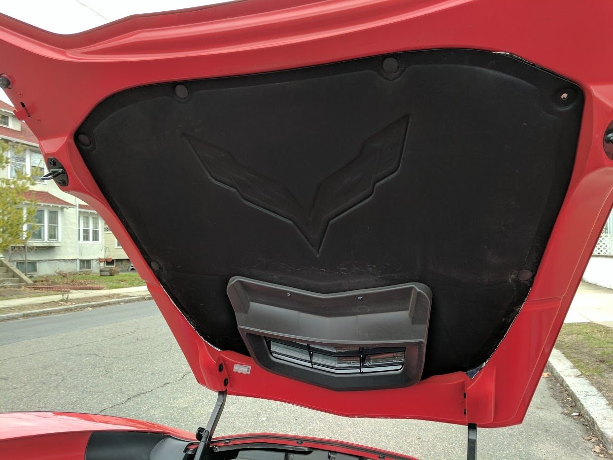

Originally Posted by xxaarraa
Gents, I went ahead and did this. And after about 100 or so miles of driving, I am happy to report that this is worth doing. Cuts/muffles the sewing machine noise by about half, noticeable difference. For something that only takes the best part of 20 minutes to do, it's a no-brainer and I recommend it.
The stock carbon fiber hood is real thin! One sheet of fatmat fit perfectly with very little trimming required. I then cut out two small pieces to place in the bottom on either side of the heat extractor. With the stock felt cover snapped back in place, it looks very non-invasive and clean. As always, careful when working with plastic push tabs as they break easily.
If someone can figure out how to get some insulation between motor and firewall, I think we will be golden (it looks tight there)
It has been a few days; do you still like this solution? The M7 fluid is changed and Noico sheets arrived today. Time permitting I was going to do it tomorrow. Thought I'd double check and see if you would do this again. Thank you in advance!
Yes, cuts the ticking noise in half. Go ahead and do it, worth the 30 minutes.

Mine is a 2017, and to me that indicates this is ongoing. Interesting TSB.
Tonight I applied Noico underneath the hood liner. I did a before/after test in the garage and there's a noticeable difference. Think you're on to something here. Noico is cheap--$20 for 10 sq. feet on Amazon. I took my time removing the pins and entire liner, so about 90 minutes total.
No road test b/c it's pouring rain at the moment. Actual road test tomorrow, and I'll post results.

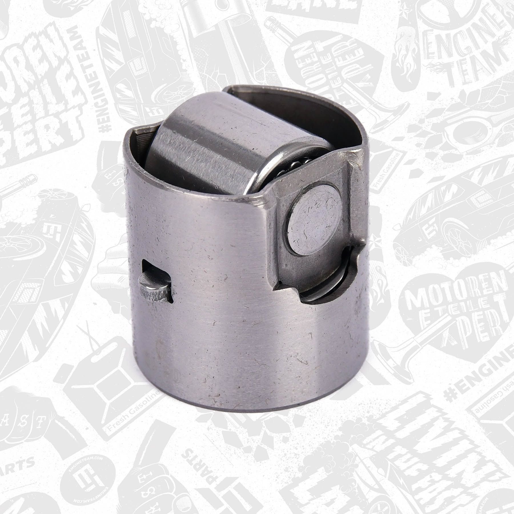

Does anybody can figure out what makes the noise? I have this nerving loud tiking also on my 2014 C7.
Under the fuel pump is a plunger witsh roll on the cam and make alternative movement. Does this plunger work as an hydraulic lifter? Compensate the gap between roller and pump piston with oil pressure?
Or is the noise comming directly from the pump?
Why does it occure only when engine is hot? mine does only when engine at working temp. If it is the pump, why is it influenced by temperature?
If oil temp has an influence, is the plunger the problem and not the pump?
What say GM to this problem ? Difficult for me to ask (live in France)
Thanks for your help

Does anyone know what exactly is producing the noise? My 2014 Stingray makes this horriblr ticking (like damaged valve train) only when engine ist hot!
=> oil temp has an influence
=> does the plunger between the cam and the pump work as an hydraulic lifter? Compensate gap between cam and pump piston?
=> is the plunger making noise or only the pump? could the plunger have oil problem and produce ticking?
=> why has temperature an influence on the noise?
=> what says GM about this anormal noise? Change the pump? (difficult for me to ask, live in France)
Thanks for help
