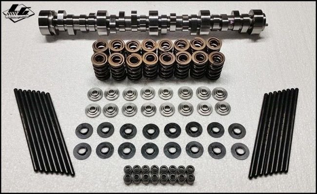

Give us a call. We have a complete range of Cams that have been proven over the years.
We had an exclusive lobe design for years with comp Cams. We have not seen any issues with comp cams over the years.
Our G7 X3 has been copied by more than a few. I guess that is the best form of flattery
We didn't win 3 national championships by accident. Give us a call.
