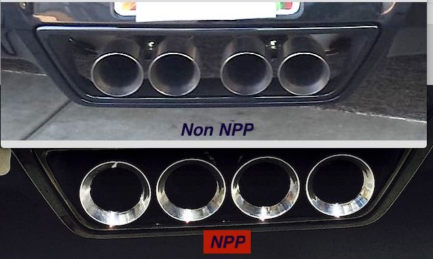

Easiest thing is to look at the size of the exhaust tips...

If still not sure, take a photo of your exhaust tips and post for us to help...

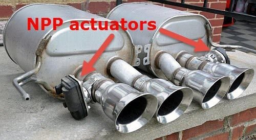

Another way -- Just bend down and look at the short section of pipe connecting the muffler to the tips.
*If you see an actuator or *any* kind of 'gizmos' on the outer pipes, you've got NPP.
*If you see just plain pipe between the muffler and the tip-- no NPP.
Picture swiped from elsewhere:
