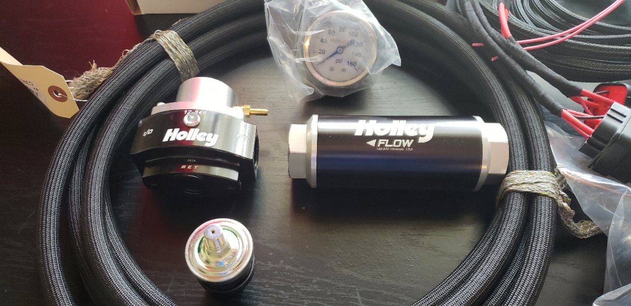

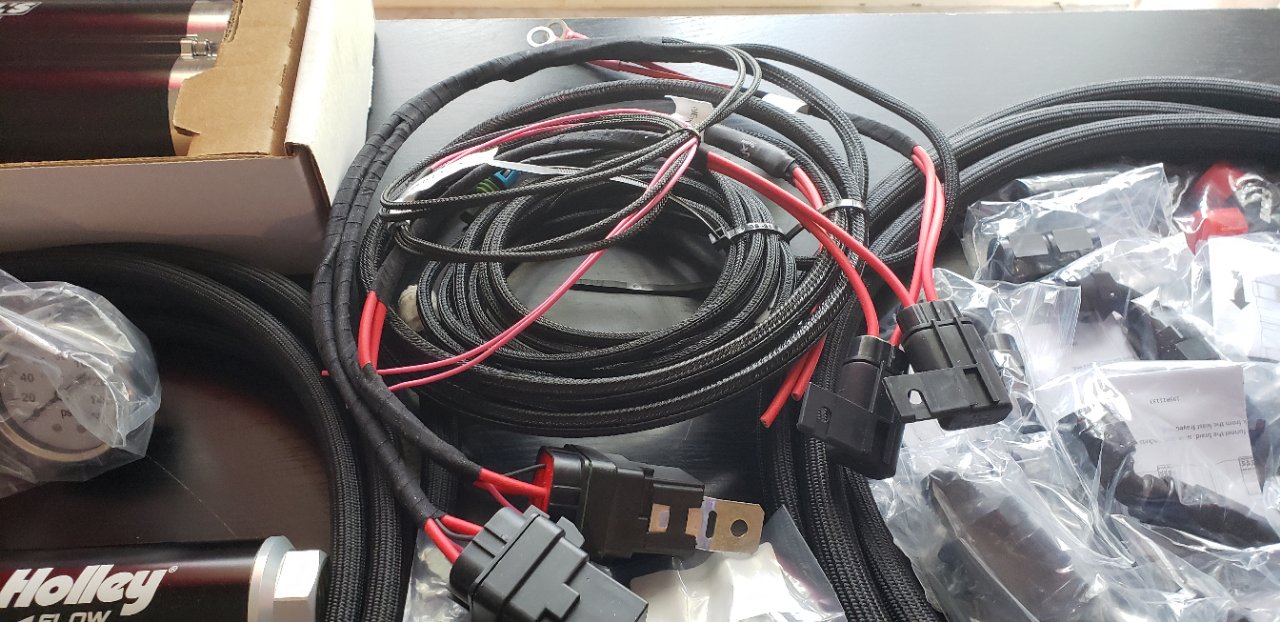

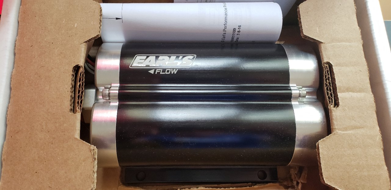

Edgyvette will be using the Crawford Racing Low Side sytems CRLS to push our PTS single turbo C7Z to well over 1000whp. The car made 842/790 on full E85 but we lost low side at 5900RPM. The CRLS system is good to well over 1000whp although we will likely only push past 1000whp on stock heads/cam etc. This kit uses the highest quality components and is direct plug and play.
Edgyvette will use the CRLS to augment the current EV950 package on the car and transform into the EV1150 package.
We should have full instructions completed and have the EV1150 on the website within two weeks.
