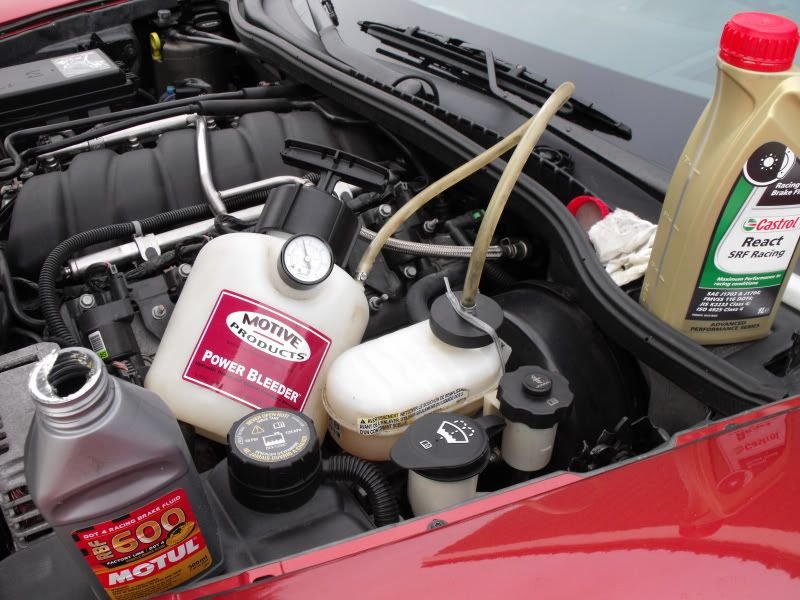

I went out to the garage to look at my Motive that I've had for many years now. The box is kinda ragged and scuffed up, but I could still see "108" on the box.
I just went and looked at the Motive site, and I think you want the current model "0108 GM Bleeder Kit".
I see they now have different "adapters" and a connector on the tubing. It looks like you can easily swap adapters for different vehicles now, which is a good feature.
You can see below that my Motive does not have the connector. Actually I had to replace the tubing a couple years ago, but the original one is shown in the old photo below, and it's just a single piece of tubing.
A couple things:
I DO NOT put brake fluid into the jug!! Any brake fluid that remains in there after a bleed is basically trash if you don't use it within a few days, or probably a week or two at most.
I just top off the master cylinder and use the Motive as a pressure source to push the new fluid into/through the system. I pump it up to 8-10 psi and it pushes the fluid out of the cracked bleed valves on the calipers just fine.
You need to make sure you keep the m/c topped off after each wheel so you don't let it get empty and pump air into the lines.
I love the Motive Power Bleeder - makes bleeding all by myself a piece-of-cake!!!
Below I was using it on my C6, but I've used it on a buddy's C5, and I currently use it on my C7:
