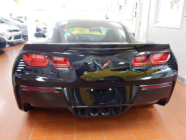

I found a 2015 Z51 for potential purchase. The only thing is I dont like the black exhaust tips. Prefer chrome.
1- Why are they black? Was this part of an option?
2- Can they be easily replaced with chrome?
Thanks all.

OK. Just got off the phone with the dealer. The owner had them professionally painted to match the rims. Thing is I don't know the details on what the procedure was when painted.
So what kind of business can i call to gather more information about the possibility of removing this paint and what it will cost me.

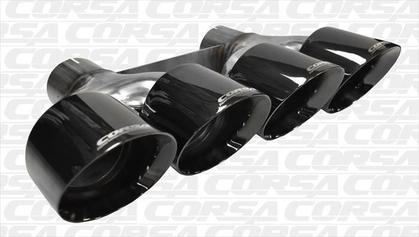

That very well could be a Corsa axleback with the Polished black tips. We have a lot of low mile take-off C7/C7Z06 axlebacks. We actually just pulled a axleback off my friends '17 Z06 NPP less than 600mi. You can have them and just pay for the shipping and handling.
It will take a 2-3 hours to swap out.
Let me know!

Corsa offers polished black tips, they look awesome IMO.

Eddie, is there a way to cut off the OEM tips and weld the Corsa tips on, or do you need to buy the Corsa axle-back?

I am not Eddie but no you cant do that the mufflers on the stock exhaust have 4 into 4 outlets & look at above pic those have 2 outlets into 4 tips.

You would have to buy the Corsa axleback.
If you really wanted to, you could buy the tips and individually cut/weld the four tips on. The only reason I could see a purpose of investing the time and effort into that is to keep the NPP.

Thanks everyone. Did some further research. Checked with a detailed friend and also had the dealers paint department look at it. The black paint/powder coat can not be removed. The chrome under the black is already damaged from the painting process.
Hopefully this will serve someone in the future who may have the same issue.
