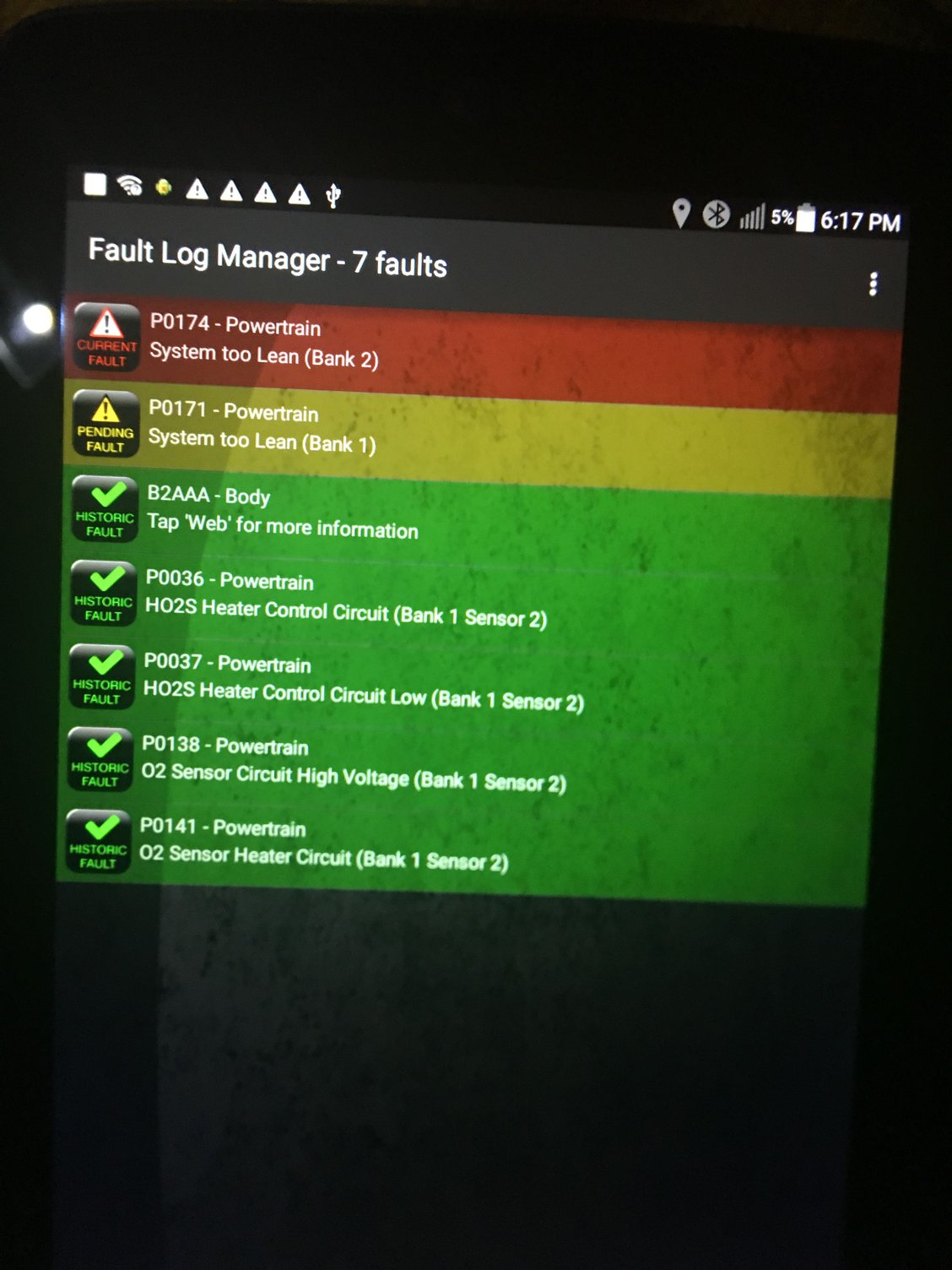

When I had an overfilled oil condition, I also had the CEL/lean code, RPMs would hang and I also saw them increase without my foot on the pedal. Ultimately, my air filter was saturated with oil so I had to replace it, clean the MAF with CRC MAF cleaner, and clean the intake tube out. Once all of that was addressed, I reset my CEL and it ran fine.
Screenshot when I was reading the code with HPTuners:

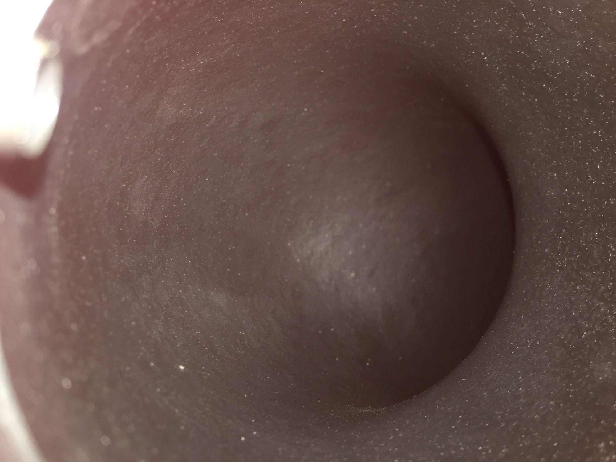

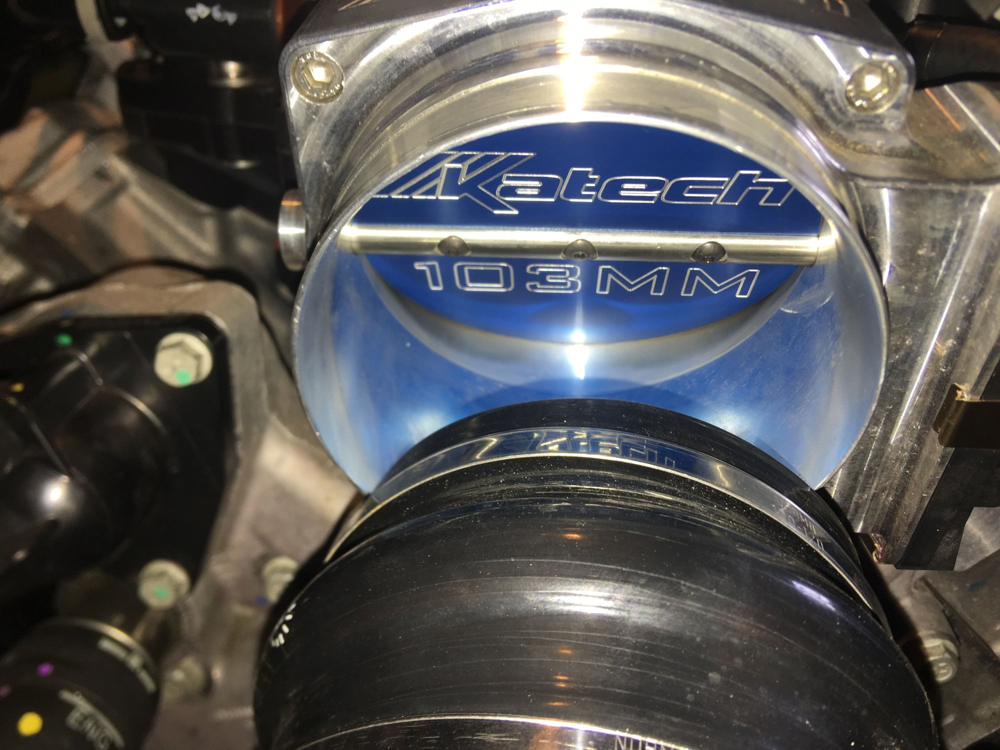

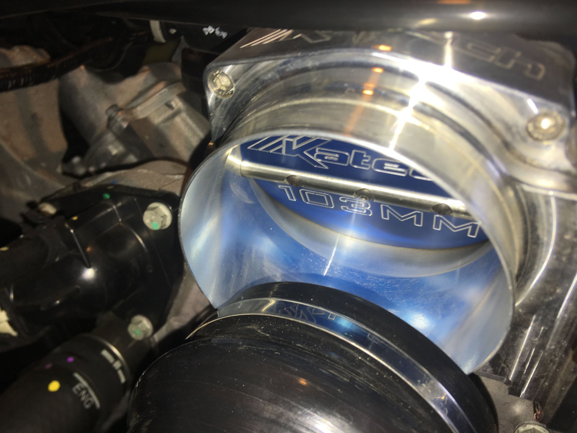

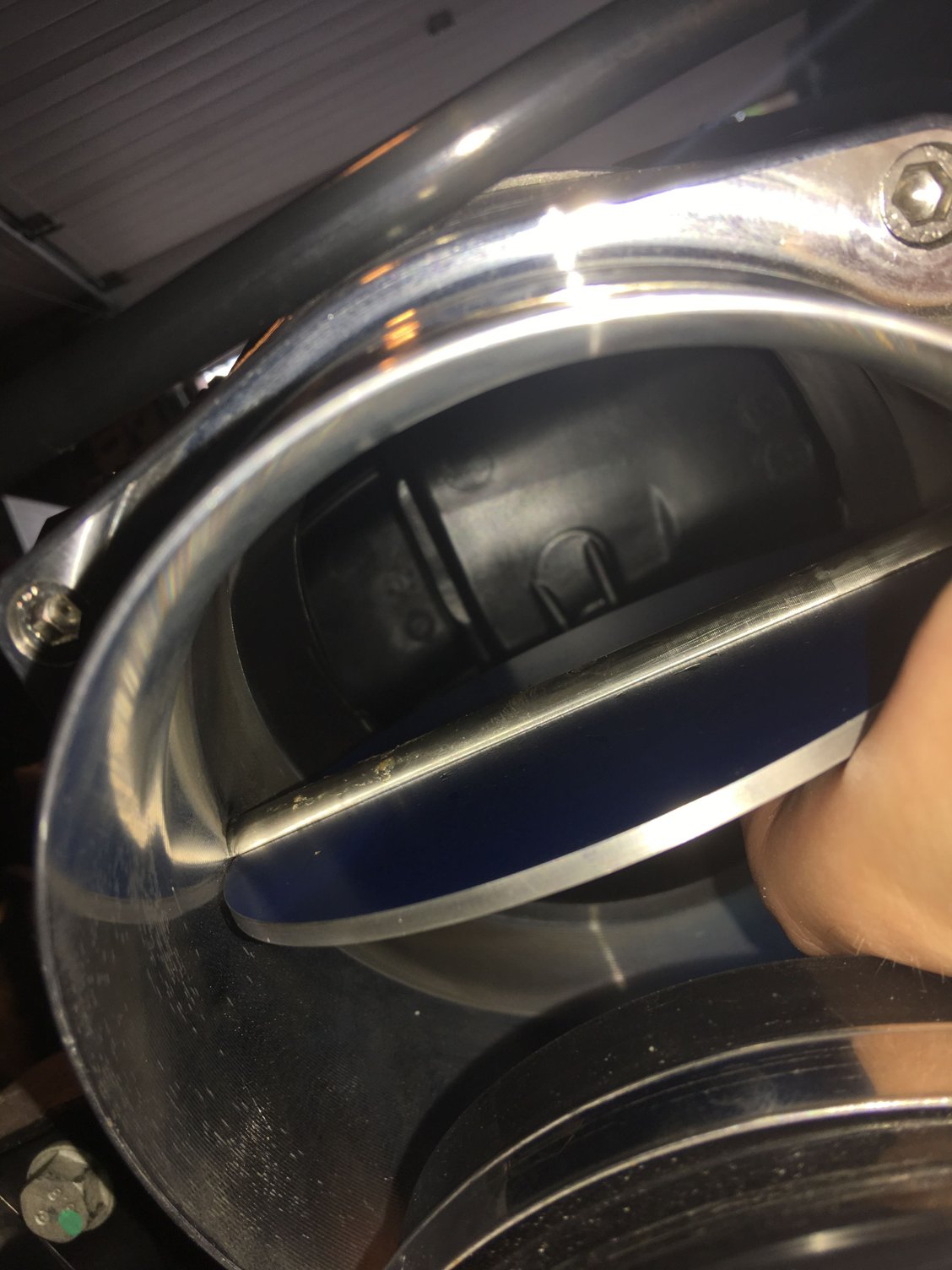

Just checked the maf and it was dry intake tube, throttle body and intake manifold also look dry as a bone.
