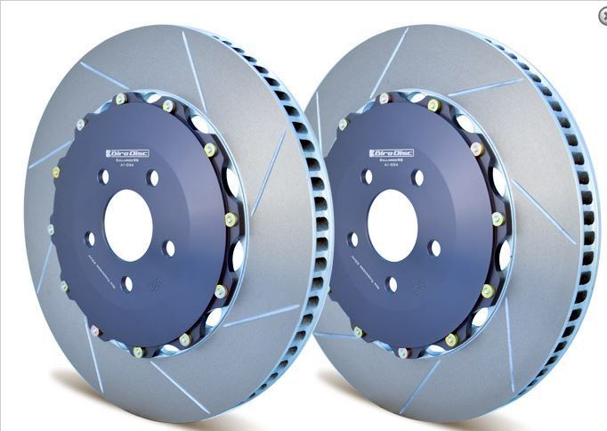

Thanks for the info. I looked at the products from DBA & Gyrodisc. I have a question about the replacements.
Looking at the OEM rotors, it looks like they are the full floating. At least that is what I can tell from the pictures I saw of the OEM rotors. The rotor to hat attachment point fasteners look just like the front rotors on my sport bike, and it has full floating rotors.
The aftermarket rotors seem to have the rings solidly bound to the hats with their fasteners. I assume this is not a critical issue since both third party companies are making them a solid unit?

Here are some pictures of the OEM one the ones from Gyrodisc.
OEM Rotor
Rotor from Gyrodisk
