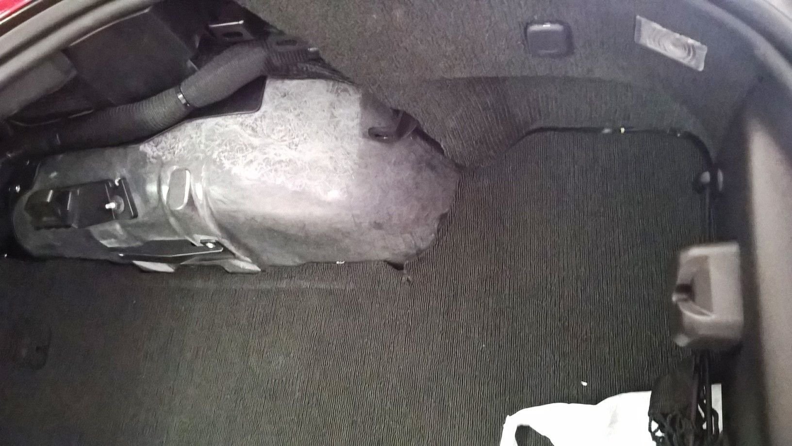

I would just disconnect the negative battery terminal for 10 minutes. All you need is a 10mm wrench. It is not a PITA, other than you have to re-index your windows afterwards, and you may loose a few settings.

I was referring to getting AT the battery is a PITA!

Also, if you do try to access the main battery in the car, I would suggest that you remove the side trim to keep from tearing the carpet. It is stiff, and seems to tear easily.
