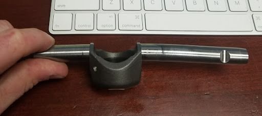

Do you by any chance(For lack of better terms.) shift like there is no tomorrow?
We had a young man bring his 2017 Grand Sport in to Weapon-X in June with the same symptoms.
This ended up being the problem:
I showed him, he said he wasn't easy on it. I recommended ordering a new one, and sending it off for to have it cryo treated. He did that week, we installed it along with a MGW STS. Haven't had a problem since.
DAMN!! How hard, or forcing of gear change would that take! I replaced lower unit w/after-market shifter & was amazed at how crappy/cheap GM (or vendor) made them, especially the cup the bottom of the shifter sits in. Looked like a Reeses peanut butter cup wrapper.
Younger motocross rider, going hard is probably a force of habit.
