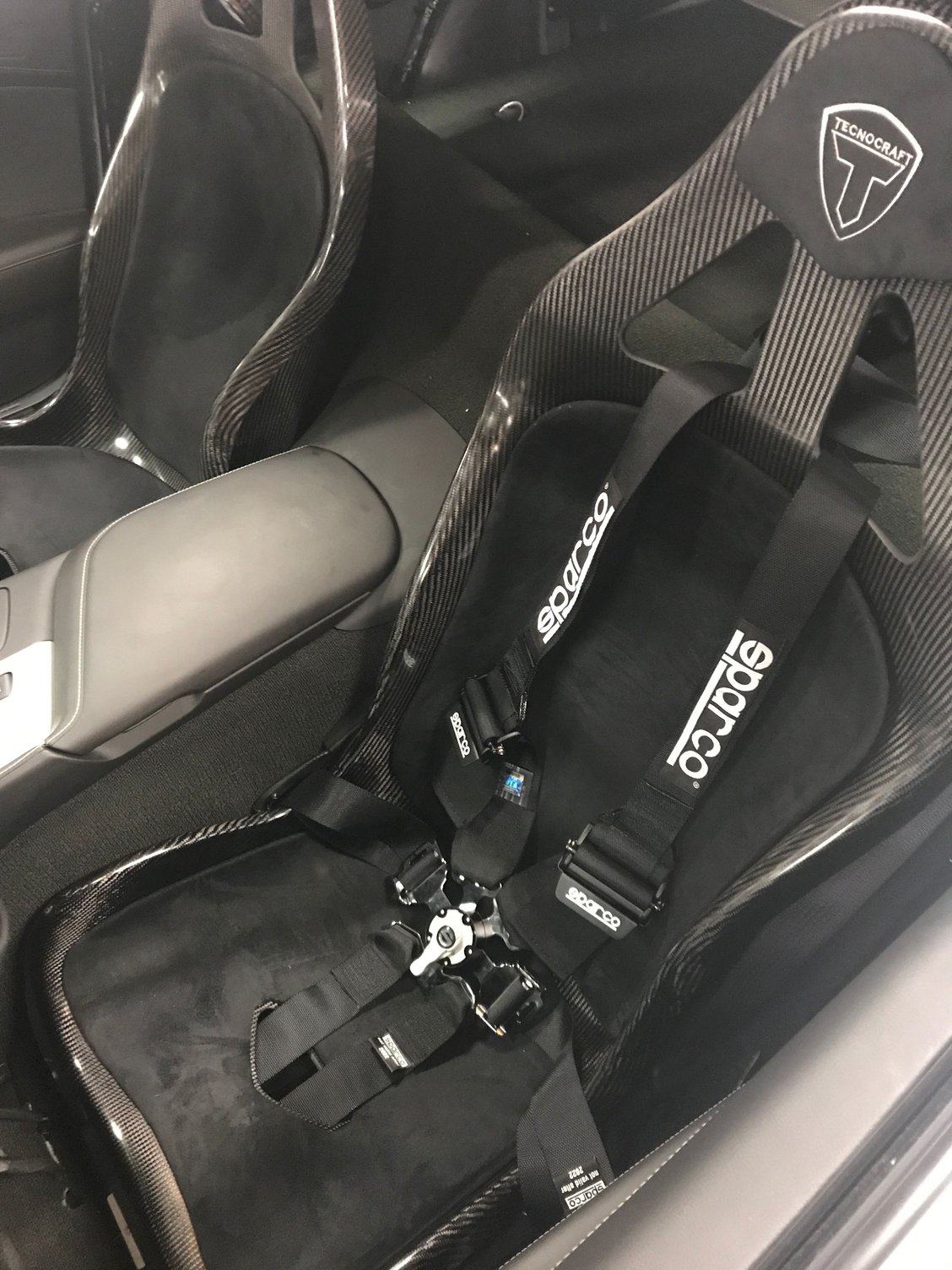

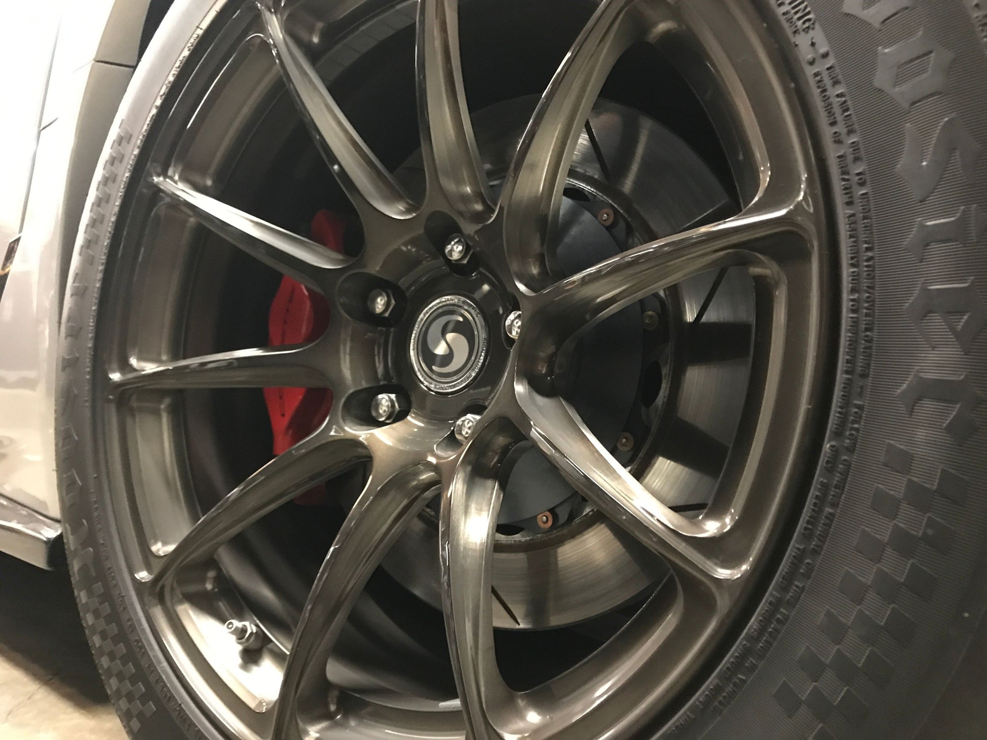

Working on it. So far brakes, wheels and tires, seats, base 1lz. I'll have her on the scales next week.

Anybody know how much lighter the competition seats are than the stockers?
The Sparco seats look bad *** but how comfortable are they?
Old Oct 6, 2017 | 01:14 AM
TAK2TRK's Avatar
TAK2TRK
Joined: Mar 2014
Posts: 239
Likes: 29
Honestly, the seats are extremely comfortable. Getting in and out isn't, as the side bolster is now hard carbon. Once your seated, I greatly prefer them. Wife approved (once seated), but choice words maybe have been used a time or two getting in. They are made by tecnocraft, and were one of the few seats that would give me some headroom and accommodate a larger driver (6'7" 240).

Comp seats weigh the same as the gt seats
